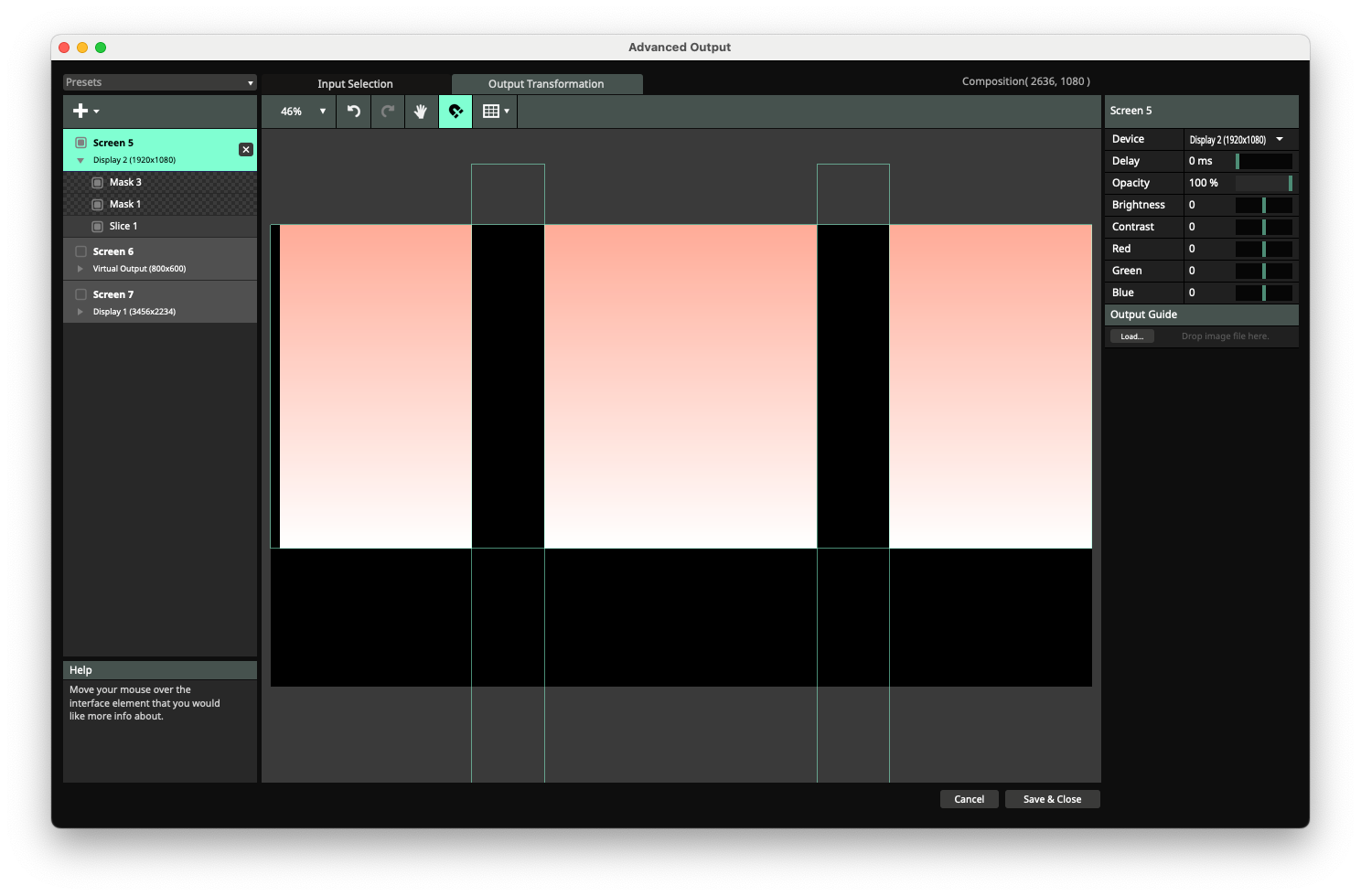

Hi there,
when I enable advanced output (I'm outputting one slice and a couple of masks to an HD TV) the composition window on my laptop disappears. I can still access the advanced output settings and even open the preferences panel, but the main interface just isn't there.
I'm running Arena 7.4.1 on MacOS 12.4.
Any ideas on what might be going on?
Thanks in advance,

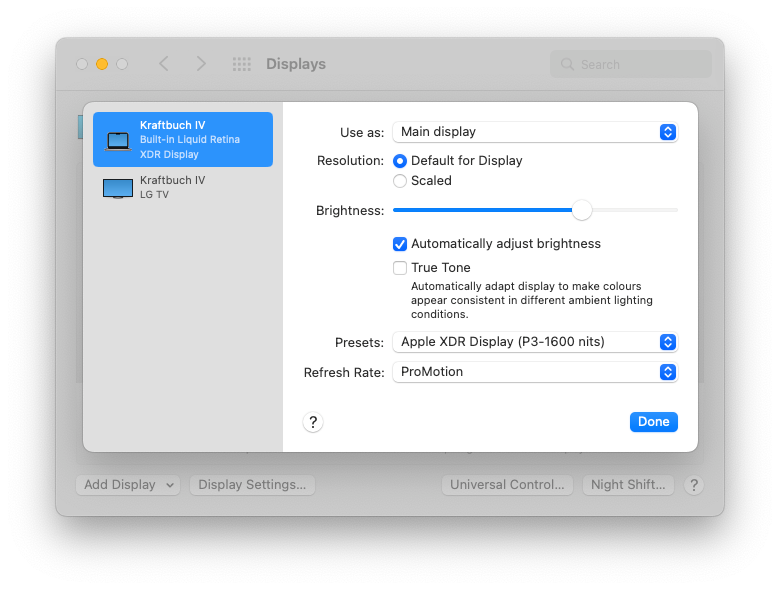

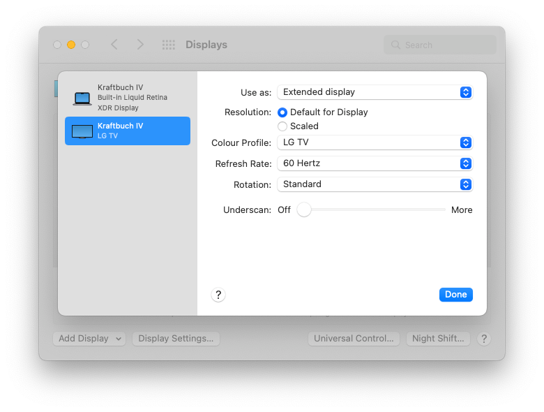

Display mirroring is disabled; I have my laptop monitor set as the main display and the external monitor as the extended display.
Any further help would be greatly appreciated as I would like to use Resolume at a big gig in two weeks' time.

Posts: 7565
Re: Composition window disappears with advanced output
could you share some screenshots of the display settings and Arena output settings?

atlibolla
Posts: 14
Joined: Tue Apr 23, 2024 13:36
Post by atlibolla »
Hi, sharing screenshots with this post!
Thanks in advance,
A.

Posts: 7565
If you right click on the app icon in the dock, choose Options, and check the display assignments there
It should be set to None or All.
https://resolume.com/support/en/osx-out ... verlapping
