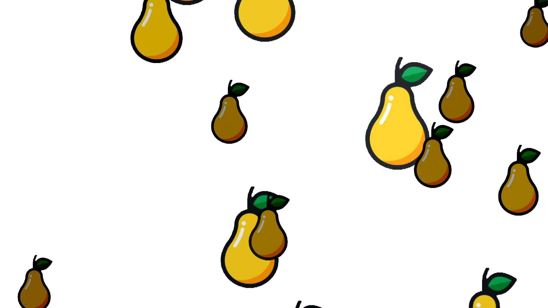

i'm building a particle/rain machine in wire.
And i was wandering iff it possible to reorder a collection of instances.
Like you can see in the image, the small pear is in front of the big one, i would like the rearrange the collection on size. So the smaller one has a lower/higher index and is renderd behind the big pear.
Reorder Instance on value

Yes of course you can... You can use the sort node to sort the size and then connect the sorted indexes to a read node to get a different order. See the included example. I hope this helps you out.

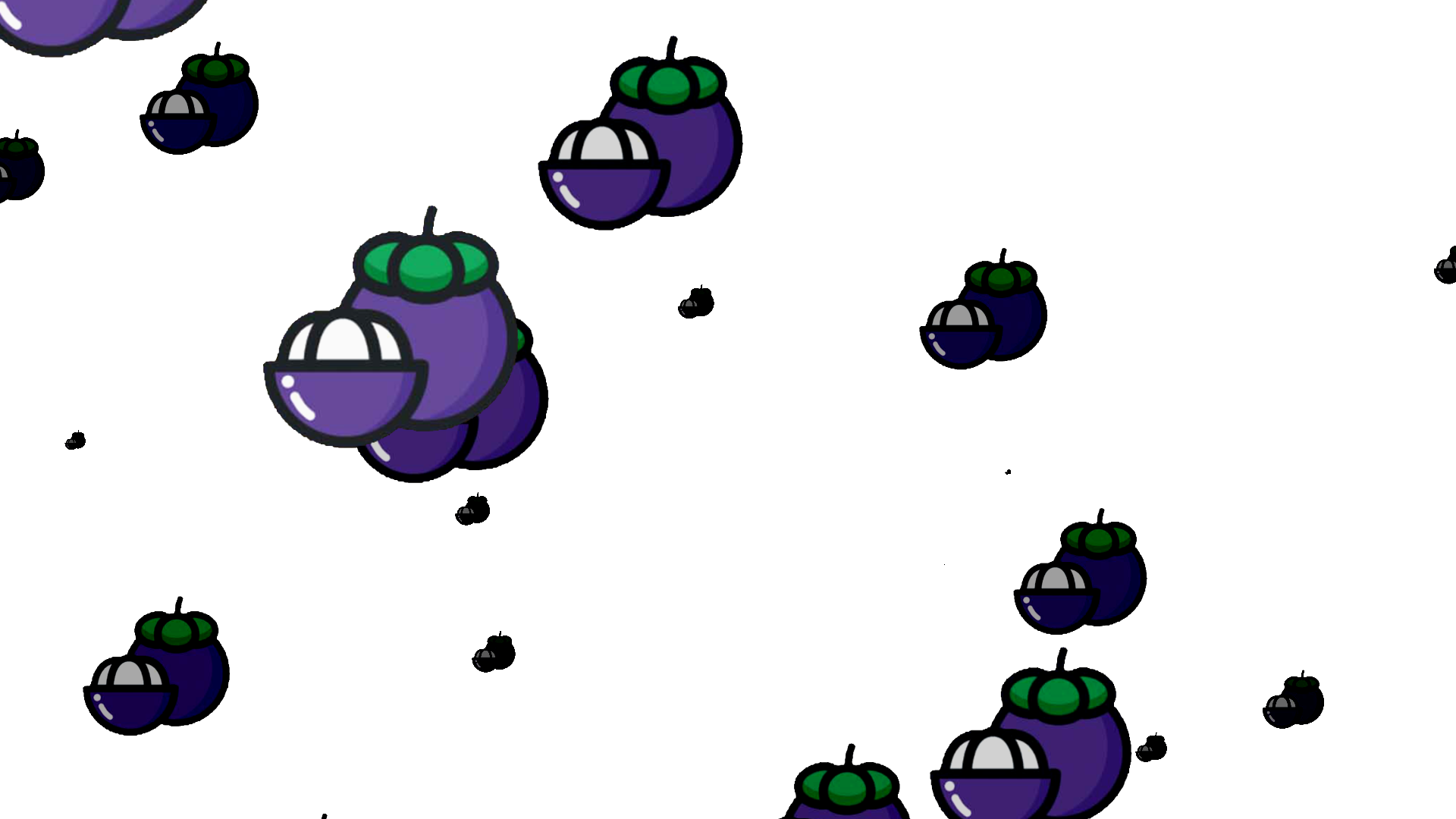

@tijnisfijn, thx! Got it working.
