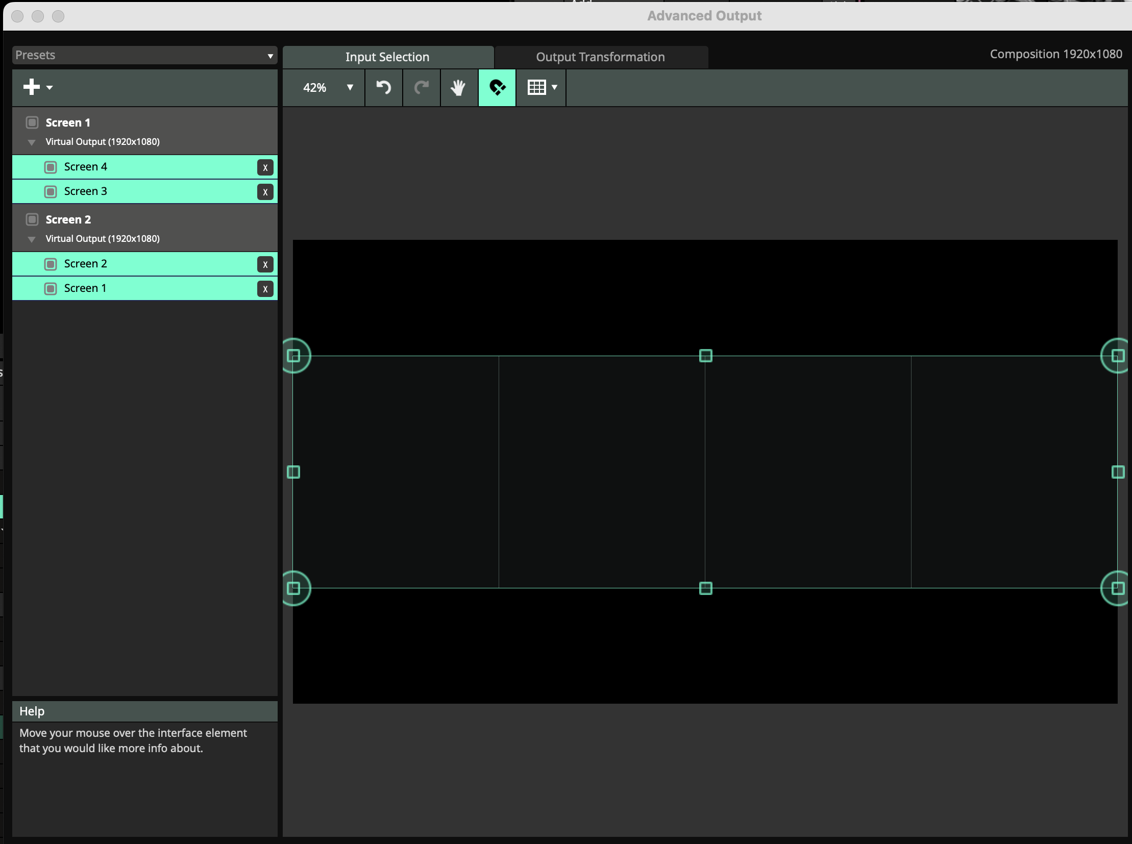

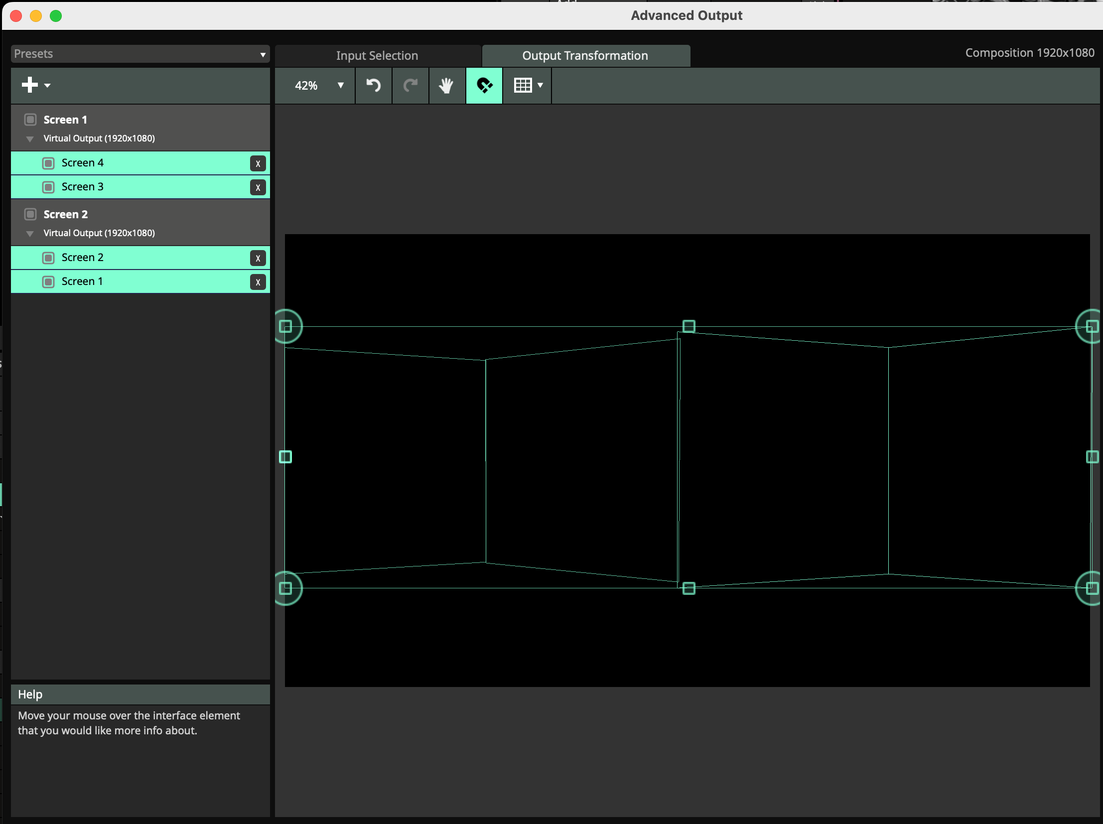

In your advance output. If you have two screens and both screens have one slice. I would give both screens two slices, one for each face of the wall it's projecting on. Then you get eight points that you can edit to match up your wall. see picts.
I hope this helps you out.
