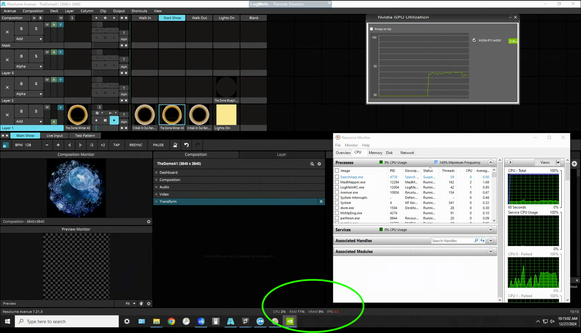

4) CPU and GPU both read below 50% the entire time even through stuttering.
5) Machine has been restarted.

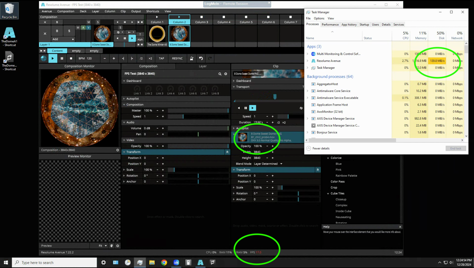

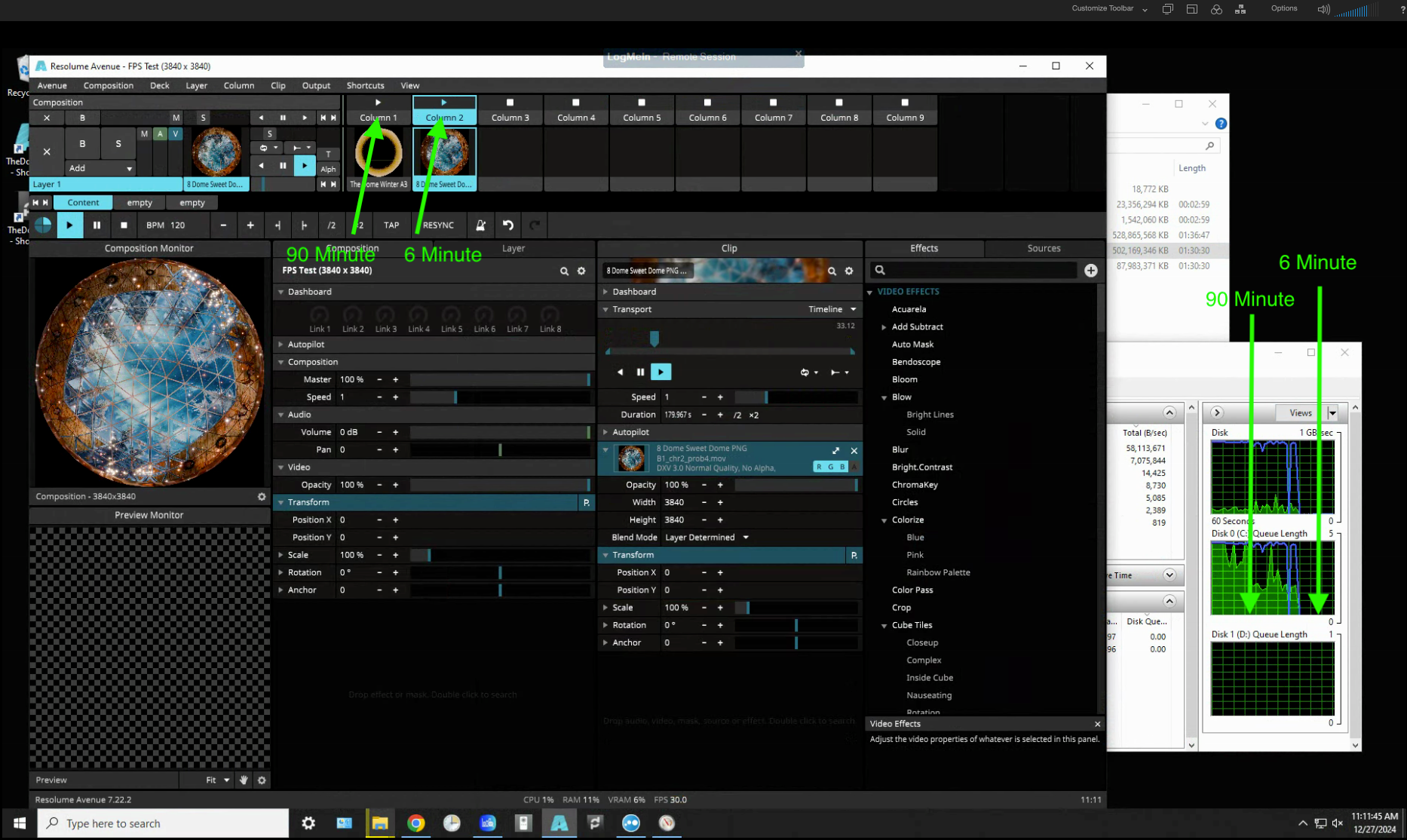

Right now my best hunch is that for whatever reason a 90 minute file is not a good idea.
This makes no sense because it was working fine for 3 weeks.
However, if I only play a single 6 minute clip (still 3840 x 3840 @ 30 FPS DXV3, etc) then it plays super smooth.
You can also see in the Resource Monitor Disk graph that utilization drops ways off when I play this single 6 minute clip vs the 90 minute clip.
This is all on the same SSD of course which is a 2TB NVMe 2280 1.99 DWPD OPAL/SED. ChatGPT tells me this is more than enough to work for this.
Going to try a different resolution next and see if that might be a contributing factor.

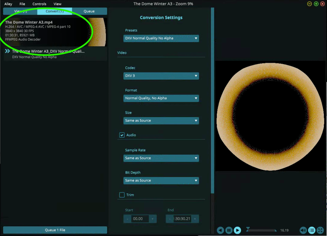

Is there anything suspect about the video codec coming into Alley?
Does it matter if the input video is H.264, .mp4, etc?

As for reconverting in Alley I can confirm I have tried that and the result is the same. Both by converting the same file and by converting a new file rendered out of Premiere.
As shown in the previous screenshot of Alley the specs are pretty standard. Would it matter at all that the file came in as a .MP4?

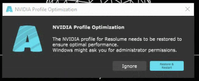

3.5) Next time I opened Avenue it stated that "The NVIDIA profile for Resolume needs to be restored". I tried hitting "Ignore" and the app did not run smooth and FPS was still low. I then clicked "Restore and Restart" on next launch and the app itself ran smoother but the FPS was still 5-10.
(See screenshot)

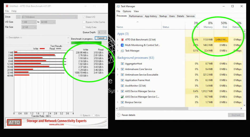

I went with ATTO Disk Benchmark instead which ChatGPT said is "Enterprise Level". It was also free and had no weird fake "Download" button ads.
https://shop.atto.com/products/disk-ben ... or-windows
I went ahead and ran this on both SSDs (identical spec and size) and the results were the same.
I found that the disk was able to write at 2.75 GB/s and read at 3.26 GB/s. This matches with spec for that drive and should be more than enough to playback videos files, right?
When doing the test and having Task Manager open the disk was only 46% utilized and was hitting speeds of 3.5 Gb/s sustained.
(See screenshot)

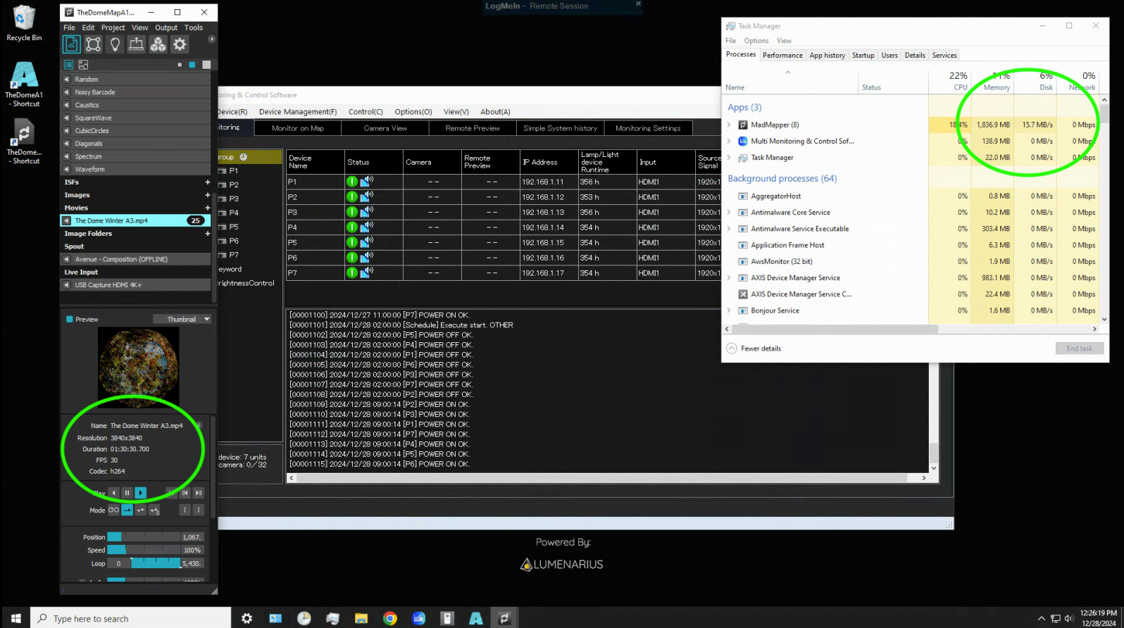

C) Disk Read During Playback
When I run Avenue and play any of the files (DXV, H.264, 6 or 90 minute) the disk is about 50% utilized as per Task Manager (about 150 Mb/s). Note this speed is the same for any of the file types or durations.
When I run MadMapper and play the H.264 files (6 or 90) the disk is only 6% utilized (about 15 Mb/s) and it runs perfectly smooth. In MadMapper this performance is the same whether or not "Hardware Acceleration" is enabled in the MadMapper Media Panel. I cannot play DXV in MadMapper.
Why might there be such a difference even with the same file between applications?
(See screenshot)
