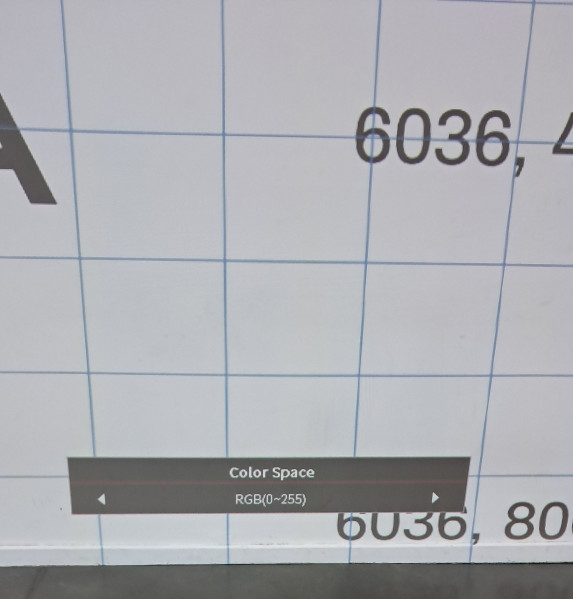

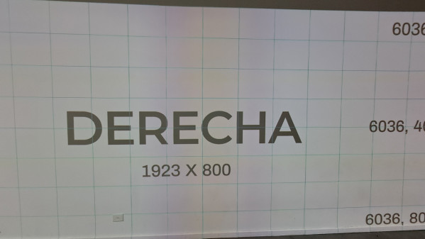

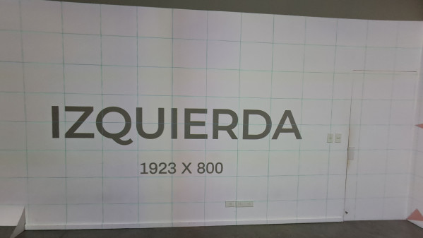

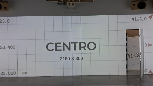

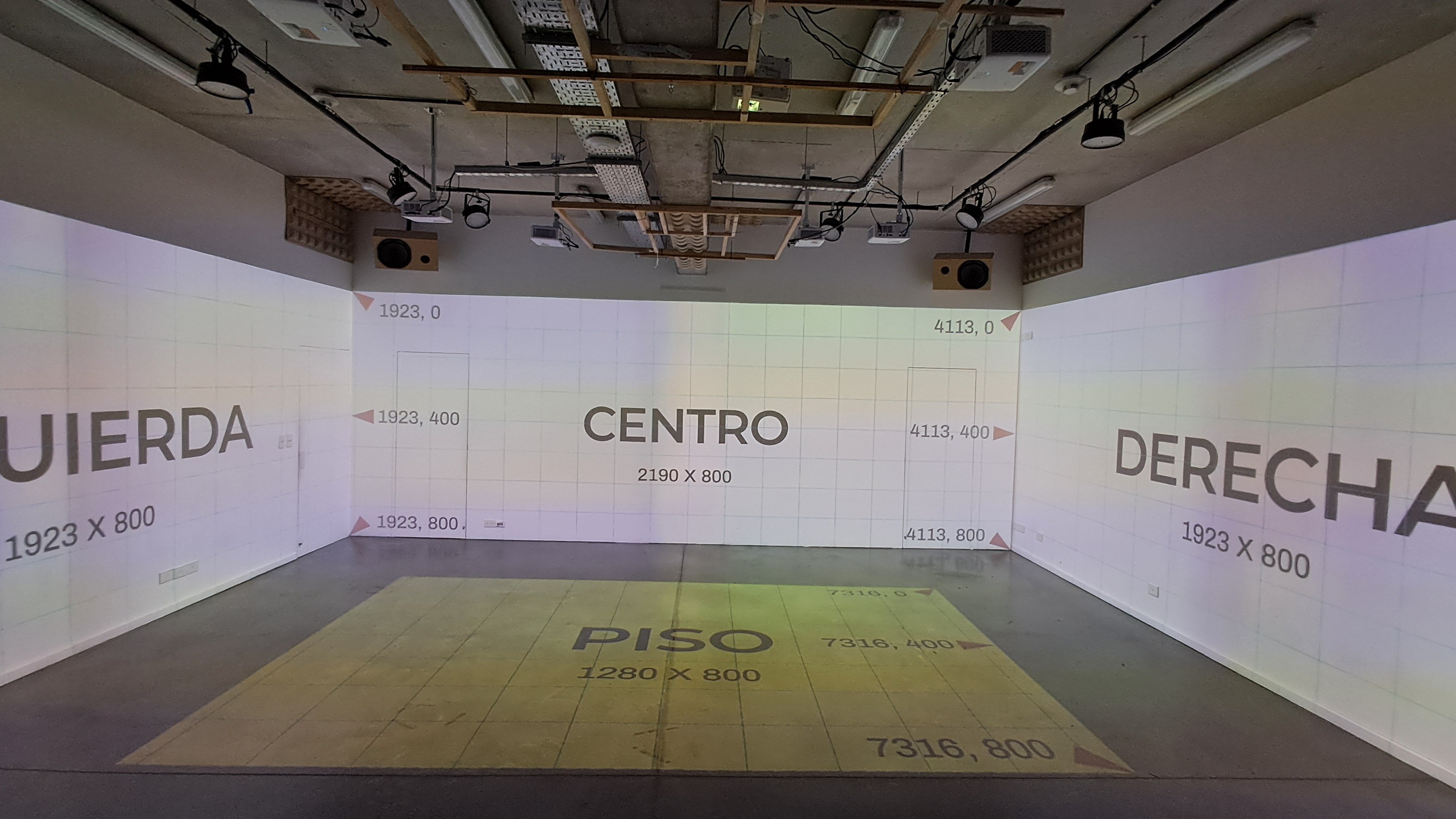

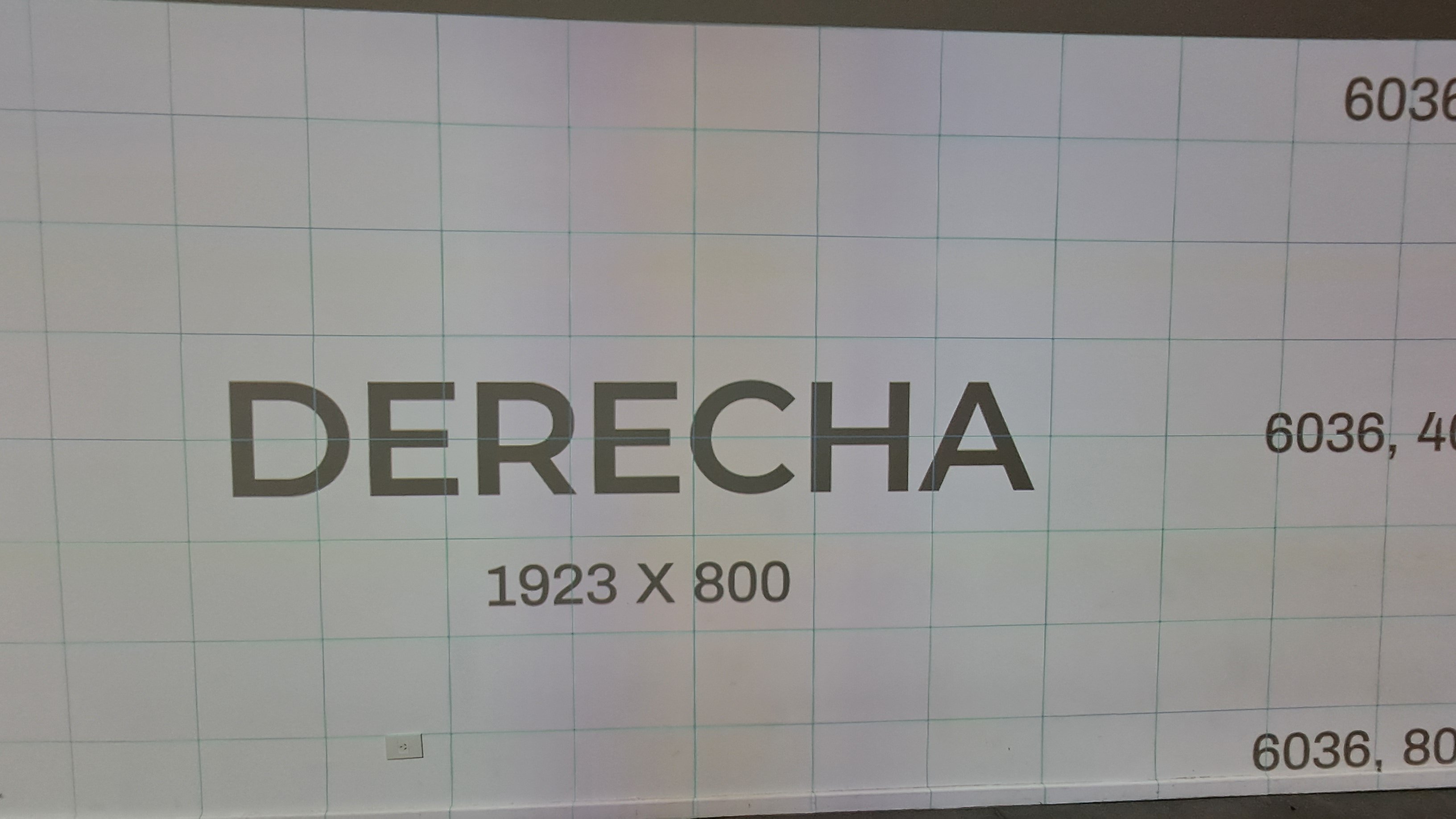

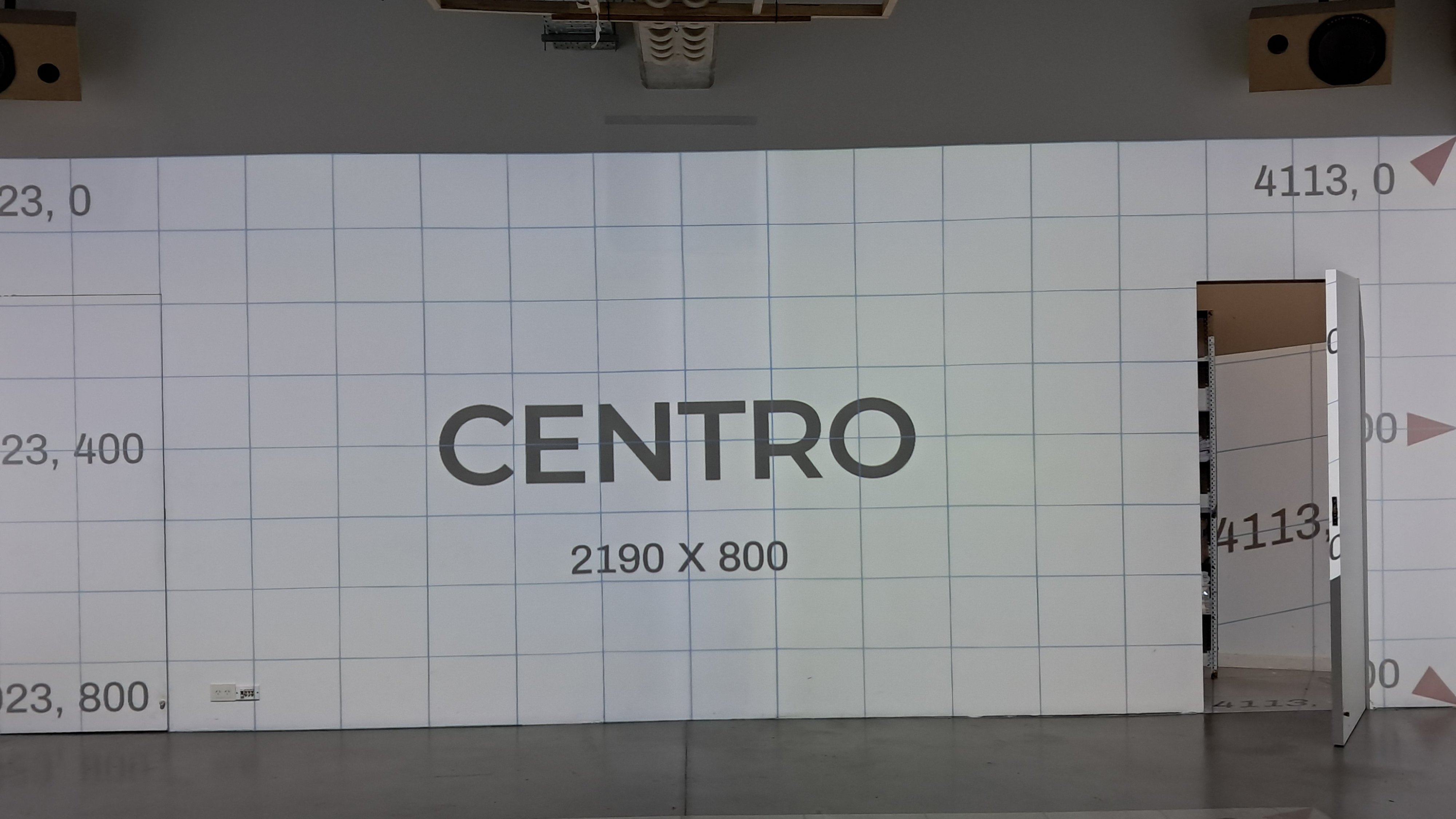

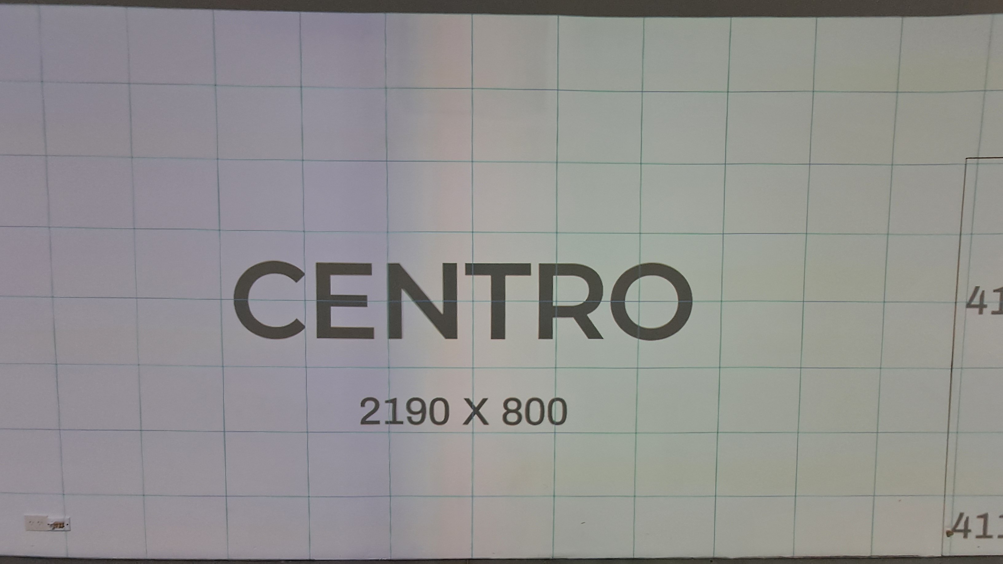

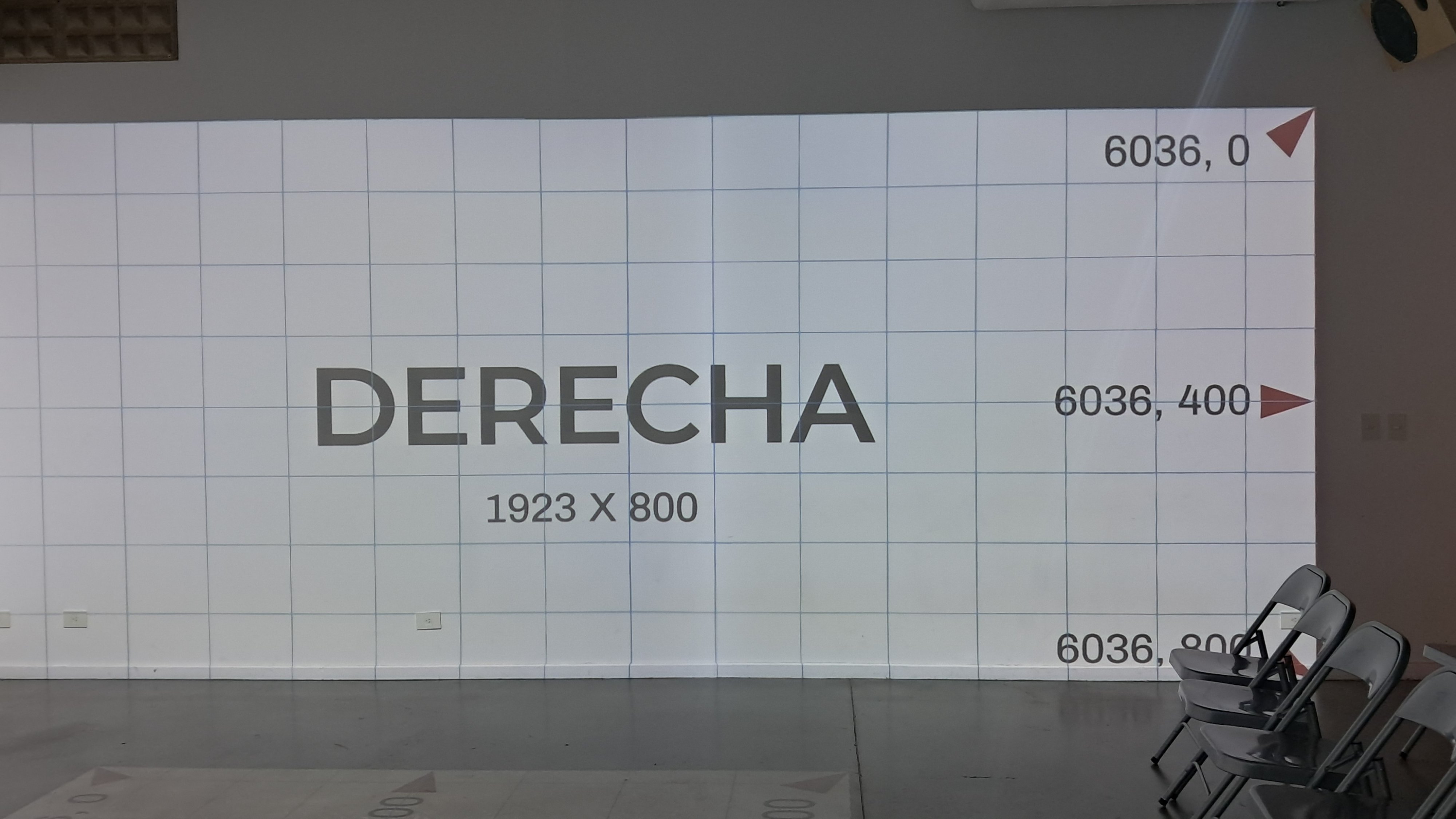

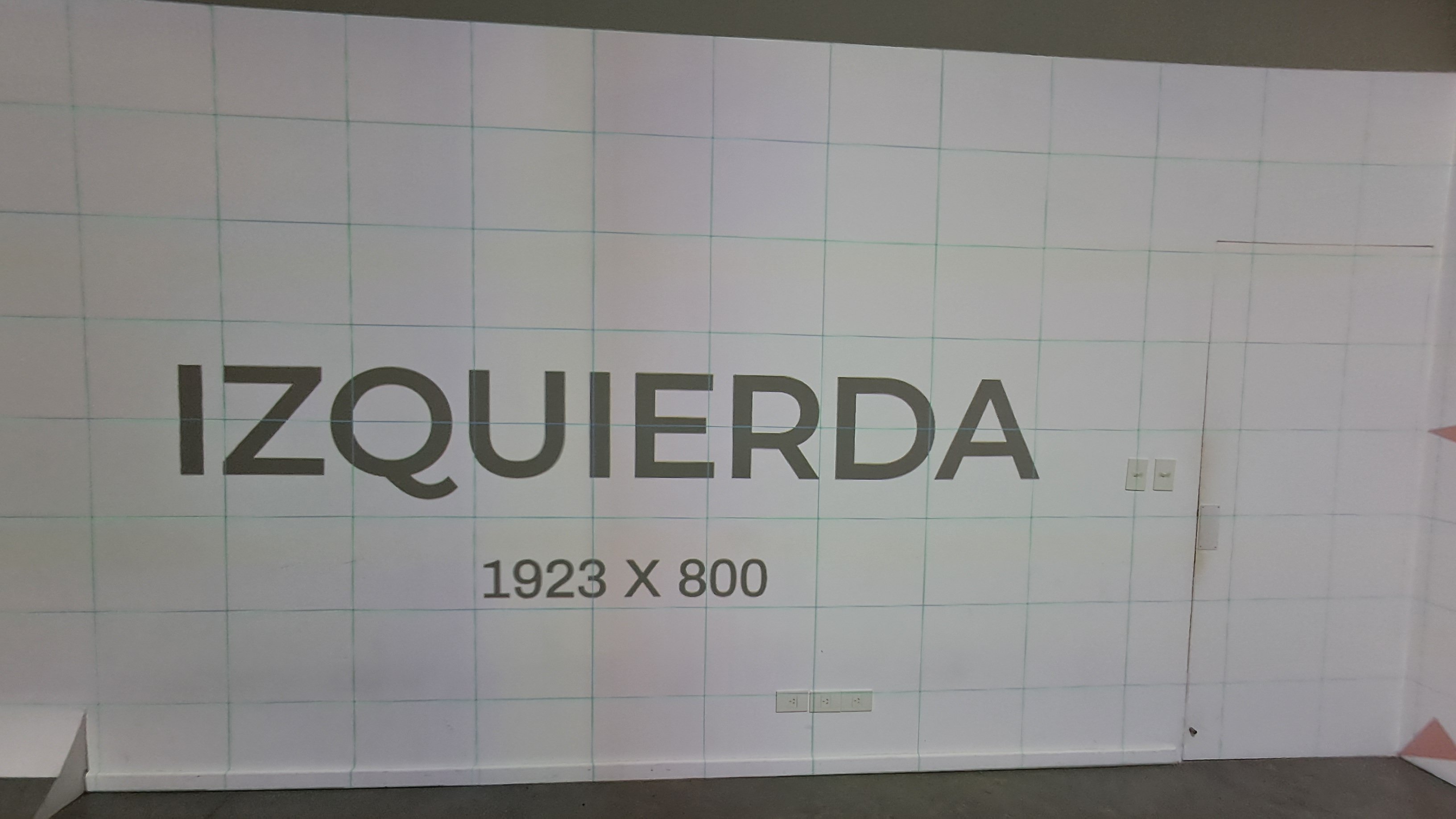

hello! I work at a university and I am in charge of the mapping room made up of 7 projectors. Until last year we had Optoma LED projectors and we had no problem setting up blending in Resolume Arena. This year we bought new Optoma projectors but they are LED Laser and I can't configure the blending correctly because I have red and yellow lines left. I know how to configure blending in Resolume well, but I don't know if being Laser projectors is making it complicated for me. I am attaching the problem files. thank you!

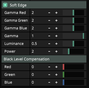

In this first photo it looks like these two projectors at "Centro" have very different colors to begin with?
Did you play around with those softedge settings in advanced output (always for both projectors of a softedge)?

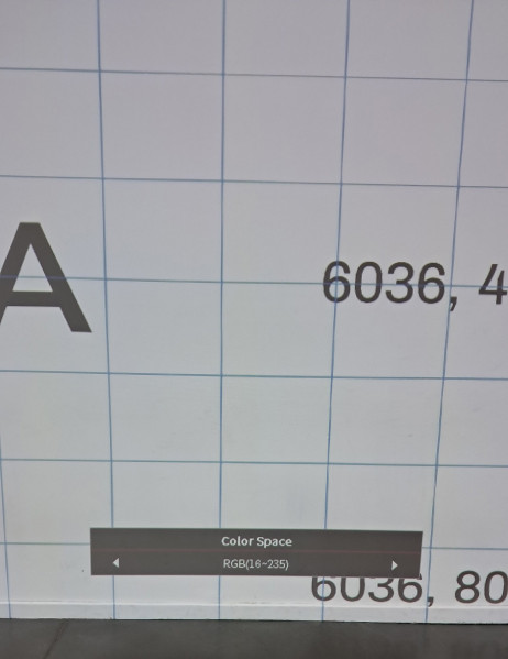

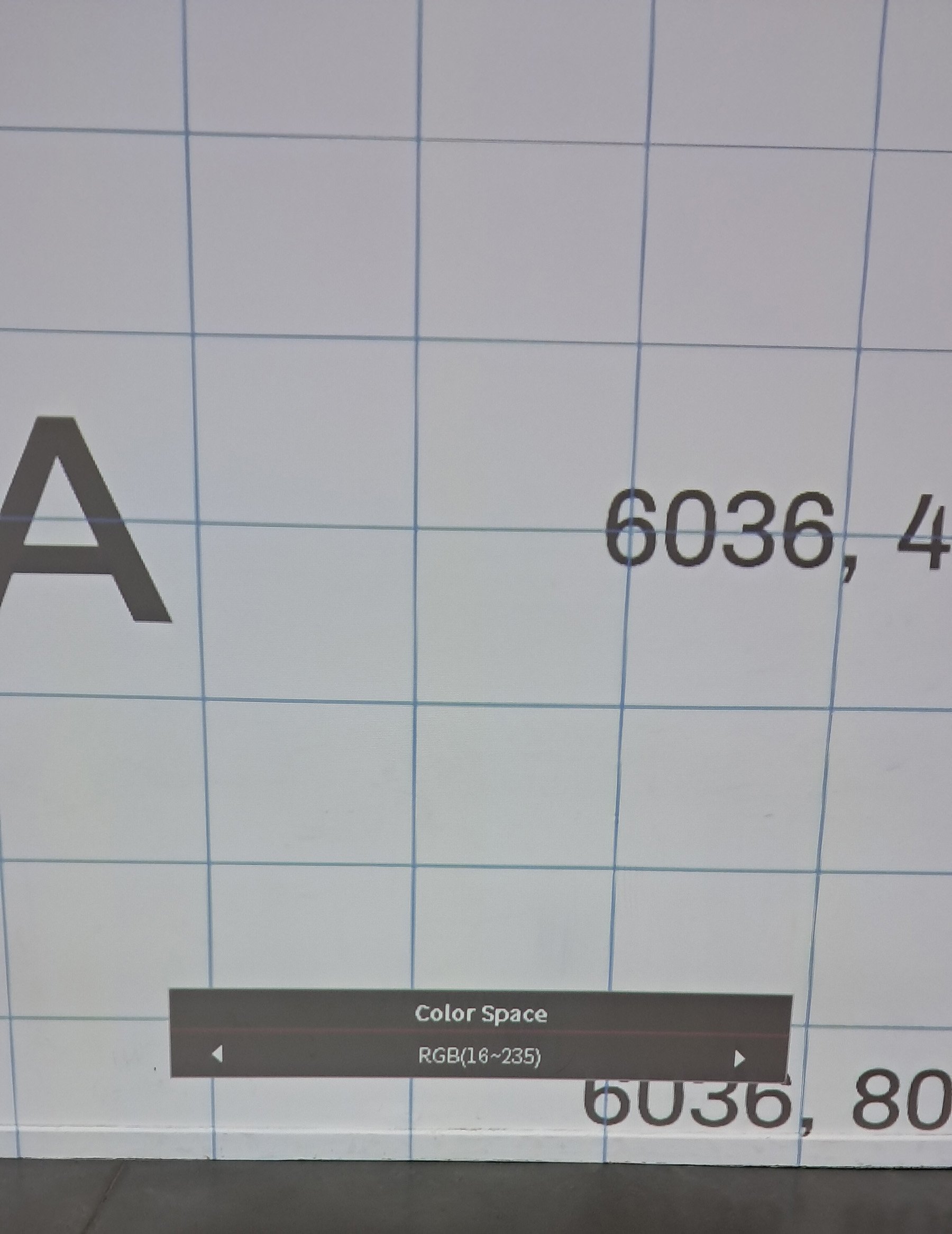

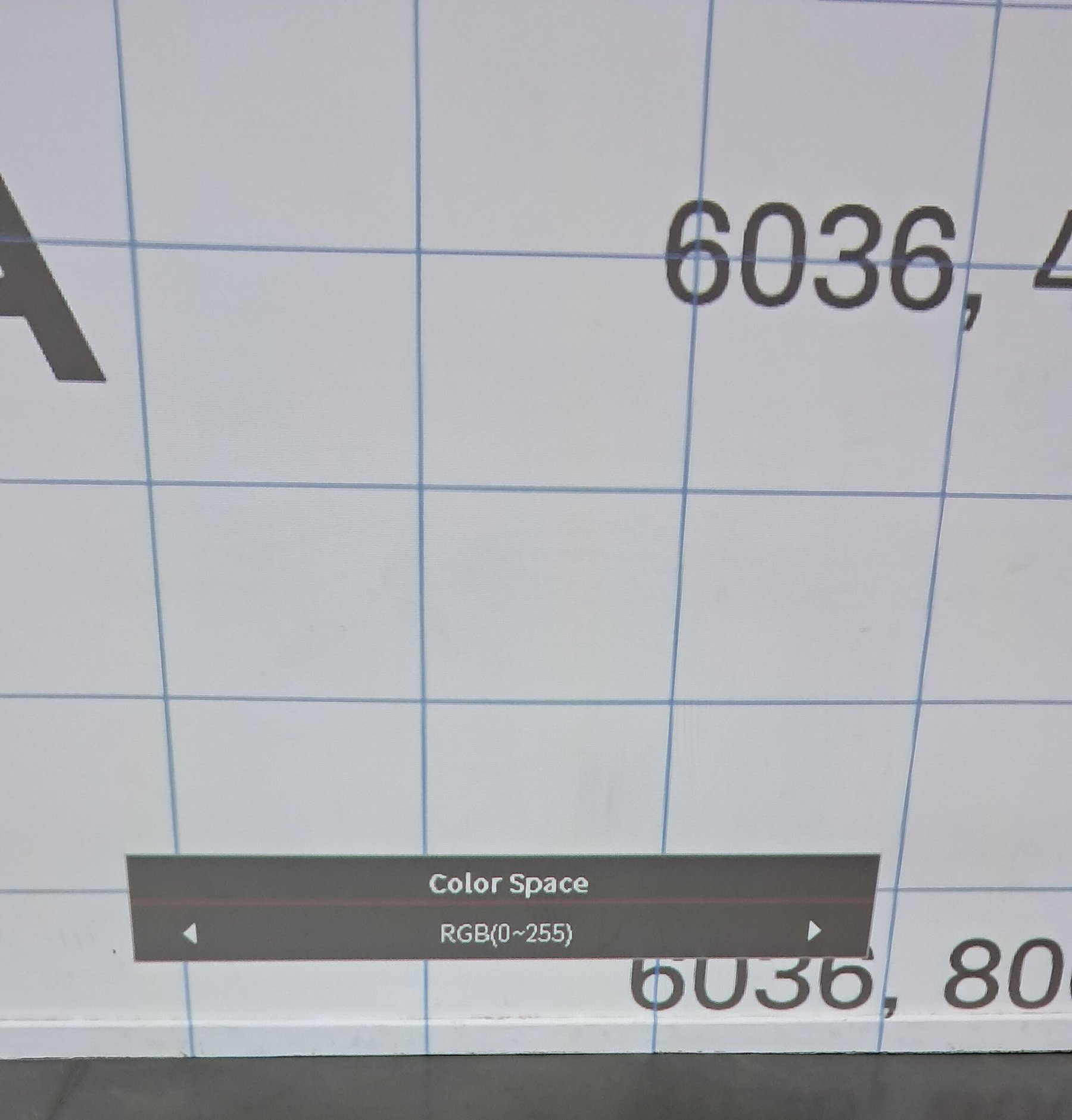

Post by nmarmol »
Thanks everyone! I was able to solve the problem, I put this value in the projectors and it improved a lot! In case someone has the same problem, I recommend changing the color space, it was RGB 0-255 and I changed it to RGB 16-235.
