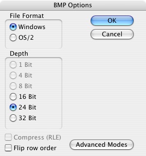

I've got some problems with my transition files, it isn't resolume's fault, but I can't make a .BMP file at 24 bits...
I just made a couple of rgb images in photoshop, I did "save as.." and then made them .BMP with 24 bits, but none of my programs (including resolume) can read these files...

make sure RLE Compression is off and it should work. Here is the bpm save dialog from photoshop (this in on the mac but it,s the same on windows)

And with what kind of image do you need to start? Greyscale 8bits or 16bits? Or just RGB?
Posts: 2240
8bit grayscale or rgb
