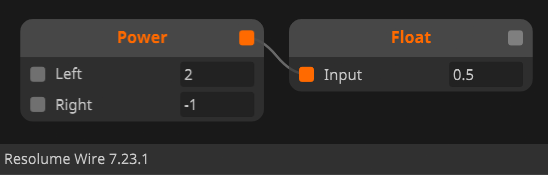

Which version of Wire are you running? It looks about correct to me on 7.23.1:
Screenshot 2025-08-25 222246.png (14.09 KiB) Viewed 15127 times

Ah, I see what happened. I had
Int In => Power => 1/x.
The result of an Integer negative exponent is rounded to zero as the result of Power is cast to Int. Then the 1/x gives inf.
Working as designed.
