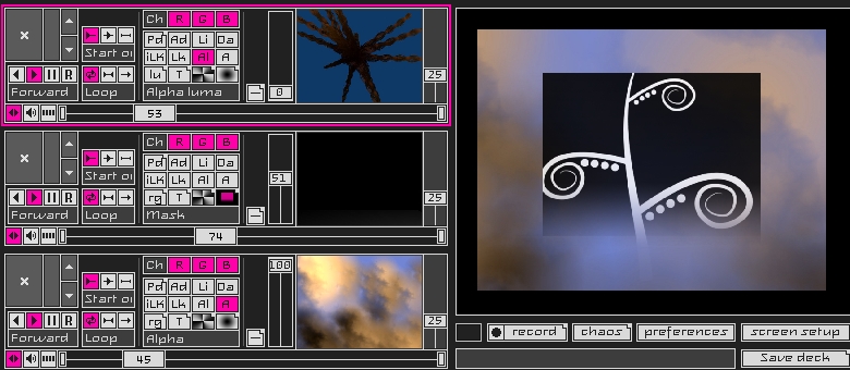

I tried it. it seems that you cant set the layer fader to exactly 50.. its either 49, or 51.
heres a screenshot of what i tried. it seems to work ok though.

Yeah, that's what I was doing (and I noticed the 49 - 51 thing). However, my mask bitmap was a bit off - I hadn't realized it, but the white parts were not all white. (RBG 230,230,230 instead of 255,255,255).
Once I fixed it, your setup yields exactly what I want.

thats odd, ive never noticed ther 49/51 thing before but your totaly right!

right click the fader on level 2/3 (middle/top) = 50 %
level 1(bottom) = 100%
works elsewhere eg effects params (think it returns them to their default).
