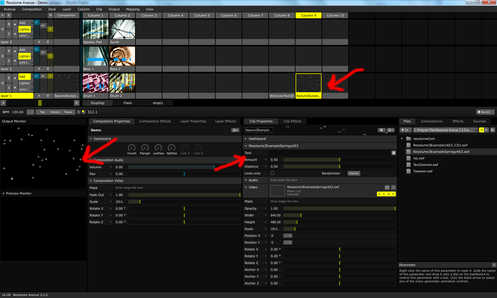

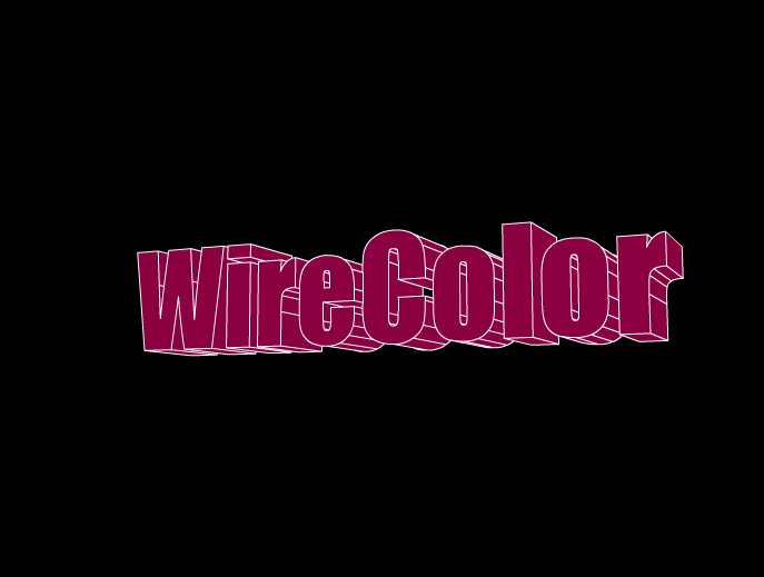

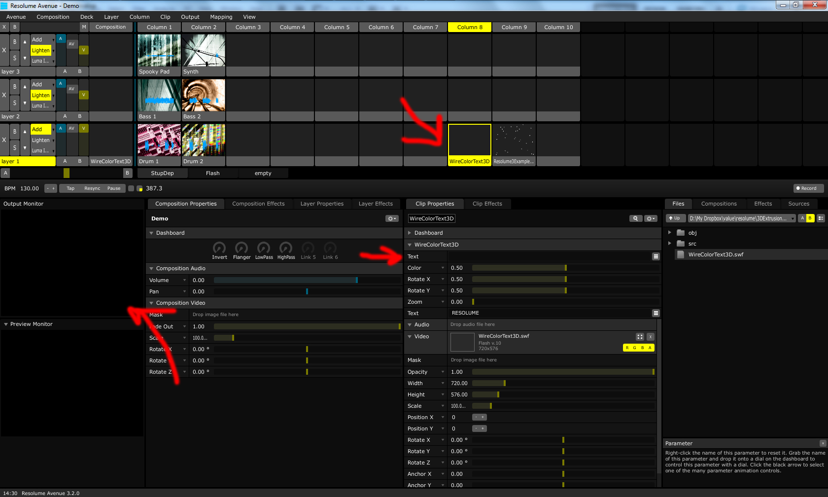

Resolume 3.2.0 / Flash Player 10.1 r52
Before I install Flash Professional CS5 I has older version of Flasp Player and my swf has worked.
After install Flasp Player version has changed to 10.1 r52 and my swf doesn't work anymore :o
And some extra text field appears.

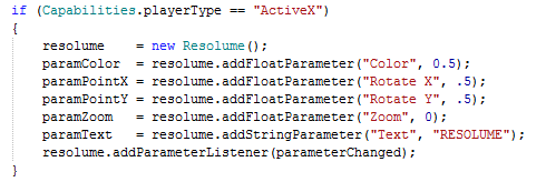

Part of my source code:

Some useful screenshots below:
How can I fix this bug ?

krybin wrote: Part of my source code:
Didn't know you could test on ActiveX existed. Good to know because the flash files are just not working when you play them in the normal flash player.
