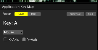

What you can do however, is to map the transport mode to a key 'in mouse mode'. After setting the axis (I prefer the y-axis for this sort of thing), you can hold down the key and move the mouse up and down across the screen to change the transport mode.
key in mouse mode image
I really hope that answers your question. If it's not what you're talking about, or if the above doesn't work for you, please let us know!
