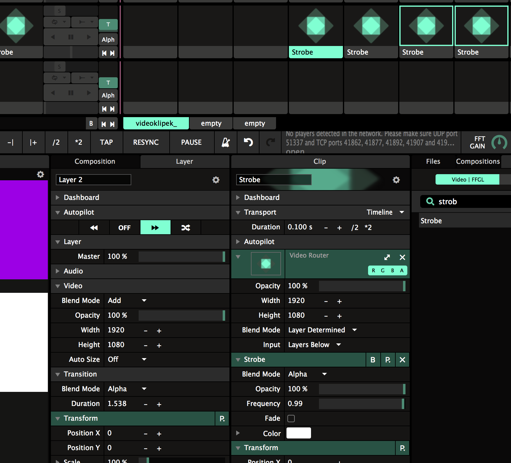

Seems to work fine for me with these settings:
I see the layer flash with the strobe, and one clip is advancing to the next in the amount of time it takes for the transition to complete.
Could you send us a screenshot of how you've set the clips up?
