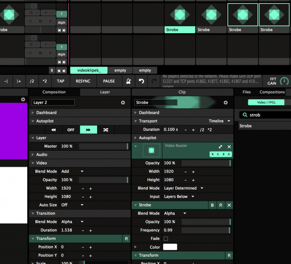

Ok, i try lots of thinks for reproduce the freeze from start and i found
I use 4 strobe effect in layer in autopilot on 4 slice (i think slice are not important)
layer are auto pilot ">>>" and duration of strobe are 0.1s (frequency 0.99).
If i do a transition time layer > 0.1s on this layer = freeze
If i do no transition time layer, not freeze, all works
Edit: i try with source -> Stroboscope, same issue when transition time in layer are bigger than duration of one clip in autopilot layer
it's PEBKAC (Problem exist between keyboard and chair) aha
,normaly i don't have transition time on this layer
Maybe we can have a "protection transition" on layer ? (force to 0) (and protection speed, force to 1?)

Re: freeze with Arena 7.0.4
hey Zoltan,
My screenshot:
https://nsa40.casimages.com/img/2019/11 ... 574294.jpg
And i send you a video of freeze on my phone in Private message
Edit: i test same on a new comp and it's work with no freeze.
my comp are corrupt i think (start comp first update of arena 7) (same preferences/comp/layer/clip option)
My screenshot:
