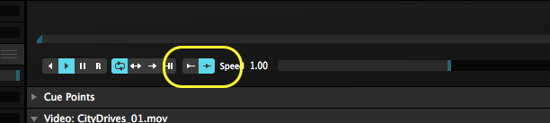

Re: 360° Projection / Arena 5, GTX 1080s, Datapath X4s
In the programming I would get feedback from resolume, checking if the clip has finished playing before re-triggering
If you really want to do this all in Resolume, you could set the clips to "Pick-up" mode. This mode is meant to let the clip pick up its playhead position from the last time it was played. In this case, it will just continue playing if it receives subsequent triggers.
Personally, I would handle this logic in whatever software or programming environment you use to get the movement data in the first place. Resolume is not really designed for advanced scripting possibilities.
