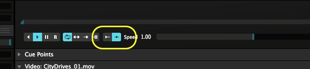

Critter wrote: Is there an easy way to configure a setup which only begins playing video once people enter the egg-shaped projection room?
I think, you would need to build custom motion detection hardware, which either would send midi or OSC to resolume. With an arduino, or raspberry Pi , and a little programming skills this would be cheap to accomplish.
In the programming I would get feedback from resolume, checking if the clip has finished playing before re-triggering, because people will stop moving watching the installation, and then the motion sensor triggers again when they move you wouldn't want the media to start again.
Re: 360° Projection / Arena 5, GTX 1080s, Datapath X4s
If you really want to do this all in Resolume, you could set the clips to "Pick-up" mode. This mode is meant to let the clip pick up its playhead position from the last time it was played. In this case, it will just continue playing if it receives subsequent triggers.
Personally, I would handle this logic in whatever software or programming environment you use to get the movement data in the first place. Resolume is not really designed for advanced scripting possibilities.
