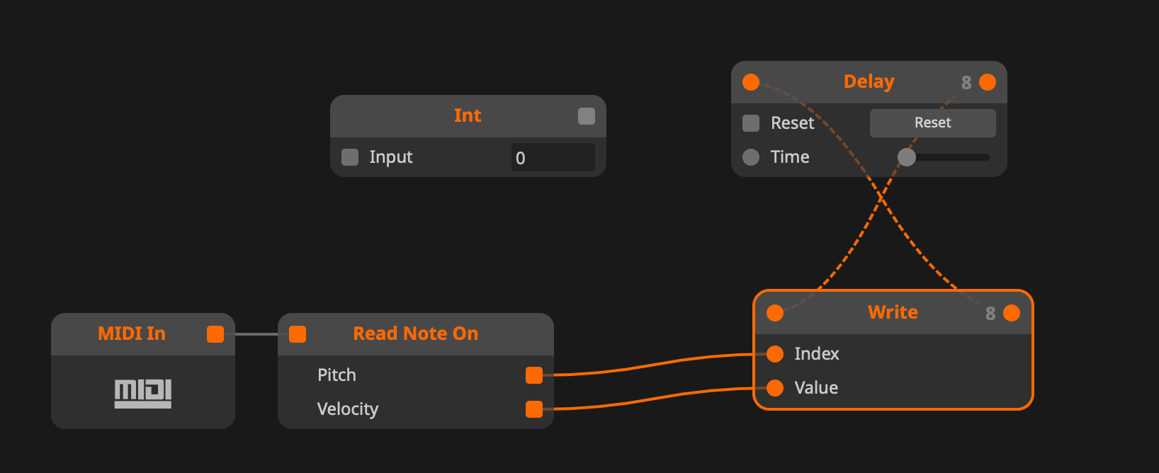

Imagine a collection or 8
Then store the midi velocity on note input, each note is the index
for some reason the collection values are automatically set to 0 again, why and how to disable this?

						Collection... stuck again
Re: Collection... stuck again
All the other inputs of the write are zero, you only write to one specific channel of it.
Write doesn't keep a state, every render pass, it checks the inputs and produces an output.
Try this basic buffer
Thanks, that does the trick!

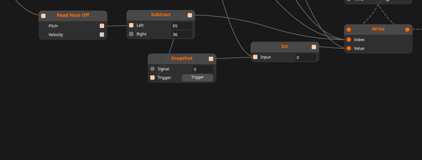

The techniques shown in previous posts are great but...  there is always a but...
In the following example everything seems to work as expected, except when pressing multiple buttons / midi notes at the same time. Then the numbers in the collection seems to get stuck / not updated.
Resulting in bars that are up while nobody is pressing any keys.
Hopefully there is a solution to this problem too?
Do you get a 0 velocity for the note offs?
Notes coming in at the exact same time though, within a single render pass, the later one will take precedence.
Write in signal is sampling at frame rate, note events can come in any time.
still no luck, I'm sure the midi or OSC sends notes off / 0's.
To much note off are not triggering the video which makes ti unresponsive, here is my patch maybe you have some suggestions for improvements
You might be running into the same issue as described here viewtopic.php?p=100107#p100107
Try this one for polyphony
