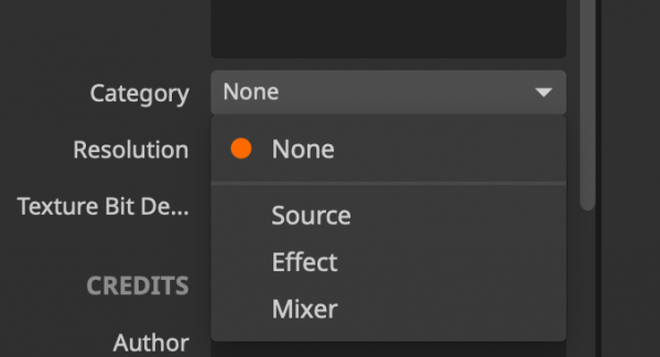

I don't currently have a license for Wire but in the mean time is there a way to test my patch from the trial version of wire? I've tried dropping it into Resolume v7.22 but it doesn't appear in the wire sources. I thought I had read on the site that it could be tested without compiling.

Re: Need Advice - Building a Clip Sequencer using OSC Data
Yes, that's about how you'd connect them up,
Your patch will work fully functional, with the watermark, so you can build the patch and test it out before buying.
When saving the patch, make sure to select a Category for it in the Wire Patch panel, after that it should show up in Resolume
Ahhh choosing a category was what I was missing, thank you!
