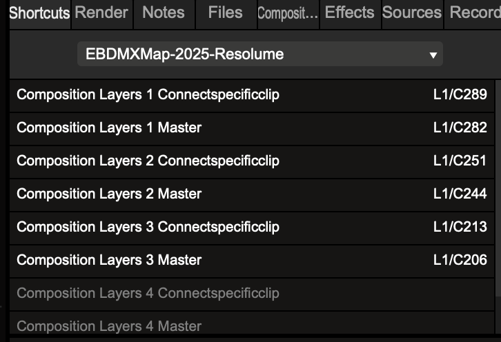

all mapped DMX values I've setup refuse to load from a saved composition, this started happening in January, and it's the second time it has happened. if I re-create them manually (I wrote them all down in a notebook), close resolume, reload they work fine. it works across reboots just fine... until it doesn't that is. after it forgets, no amount of reloading the composition or rebooting helps. at that point, the only option is manual re-creation of the DMX shortcut remap. help please?

here are the two files I found in that DMX directory. It's not a complex map, I just use it for some simple layer clip selection and level control in resolume (5 layers). the one called "EBDMXMap-2025-Resolume.xml" is the file I saved the day that I recreated the DMX map (the third time). I'm guessing that the file called "Default.xml" is the screwed up file? I never bothered to save the DMX map when I first created it, years ago (and in turn, re-created it again after it glitched for the first time, months ago). I guess if/when it happens again, and if that "default" file is not the problem child, I'll know where to look. Thanks!
