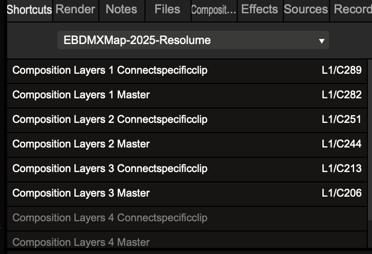

here are the two files I found in that DMX directory. It's not a complex map, I just use it for some simple layer clip selection and level control in resolume (5 layers). the one called "EBDMXMap-2025-Resolume.xml" is the file I saved the day that I recreated the DMX map (the third time). I'm guessing that the file called "Default.xml" is the screwed up file? I never bothered to save the DMX map when I first created it, years ago (and in turn, re-created it again after it glitched for the first time, months ago). I guess if/when it happens again, and if that "default" file is not the problem child, I'll know where to look. Thanks!

Re: 7.21.3 suddenly forgets all DMX mapped shortcuts
Both these look undamaged.
If you delete stuff in the default preset, those will be gone when using other compositions.
Compositions and presets are separate.
Compositions saving stores the active preset reference in the composition, and Resolume will try to load that preset on opening the composition.
So, if these are the only files you have in the DMX shortcuts, I'd say you might be reusing shortcut presets.I never bothered to save the DMX map when I first created it,
