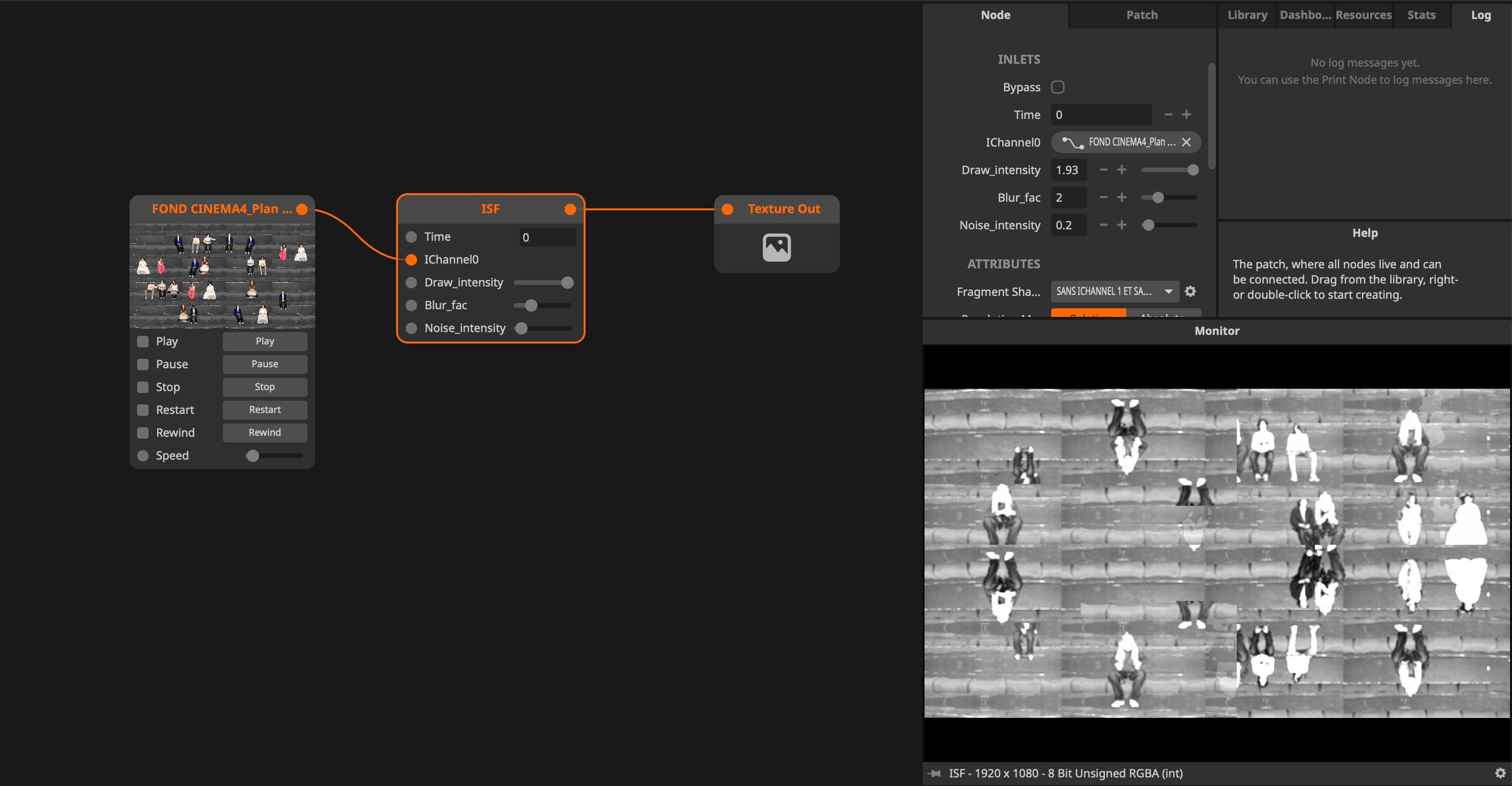

I modified I shader from ShaderToy (https://www.shadertoy.com/view/DlBSRm). And now this works perfectly in ISF Editor. It's a Motion track shader, it show only the moving pixel of the video. I imported it in Wire, and now the ISF in Wire only takes the textureIn, apply the Draw INTENSITY, BLUR FAC... of the effect on the textureIn (IChannel 0) but doesn't apply the movement tracking. Here a screenshot joined and here is the code. ALSO Here is a link to the editable compiled patch https://docs.google.com/document/d/1W54 ... drive_link Every ISF using buffer (I think this one do that) I'm using in Wire seems to have problems.

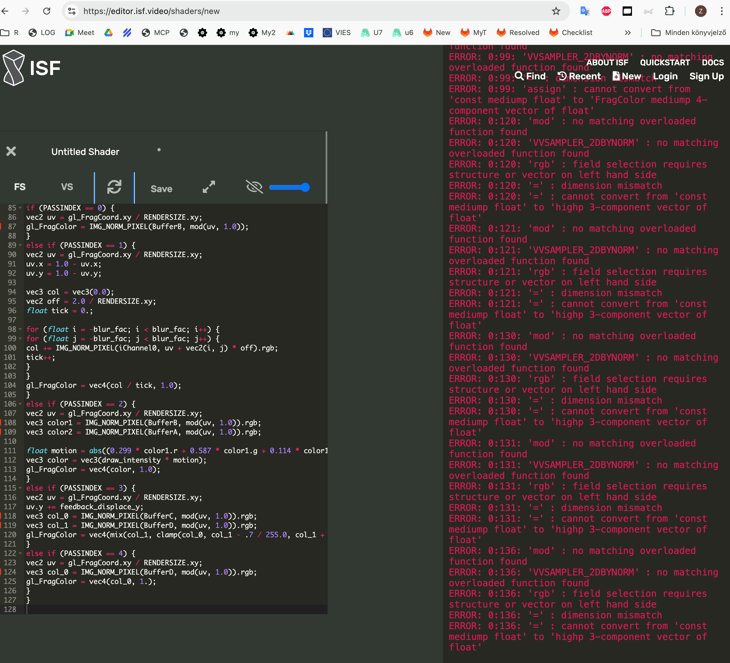

Posts: 7765
Re: ISF with internal buffer seems not to work in WIRE
Might be the formatting, but I get a bunch of errors with this code on the ISF site.
the drive link points to a doc, not the pathc, so can't check that.
