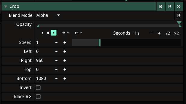

Fantastic idea! I've got some time to implement changes this morning!Christoph wrote: Fri Aug 29, 2025 16:40 There is no fade for the bypass-button. You could however animate the opacity-fader with play once and hold and make shortcuts for those 2 little forward- and backward buttons. Or you animate the other crop parameters, if you don't want to have a blend but a smooth transform from one crop to the other.
Thank you!
Re: Bypass effect fading?
So, moving between these options is quite clunky. I have the option to make commands wait for one to finish etc.
This is a screeny of the three crop options I want for this layer, and there's going to be the same for two other layers. Have you got a 'best practice' idea for how to time it so I'm not seeing three crops adjust at the same time?
