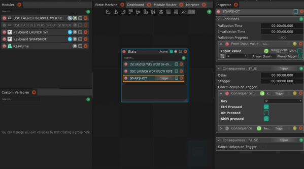

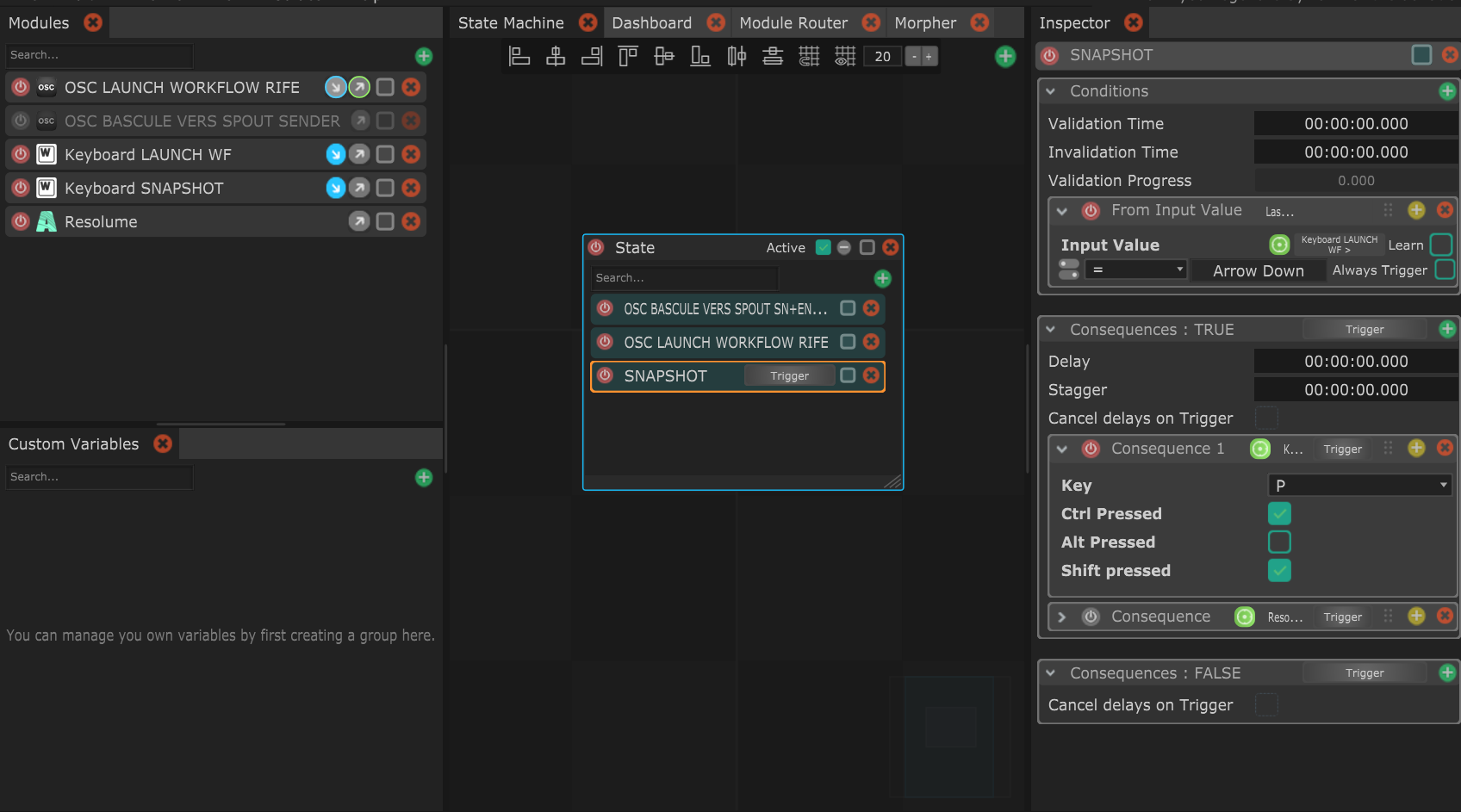

I’m trying to launch the CTRL+SHIFT+P command with Chataigne. I understand that Resolume needs to be the active window when sending the keyboard shortcut from Chataigne. Unfortunately, it doesn’t work. It doesn’t work with CTRL+SHIFT+A either, for example. Did it work on your side?
I’ve attached a screenshot, but I can't load Chataigne file, but here it is with link : https://drive.google.com/file/d/1-XV-WT ... sp=sharing in case it helps.
Best regards !
