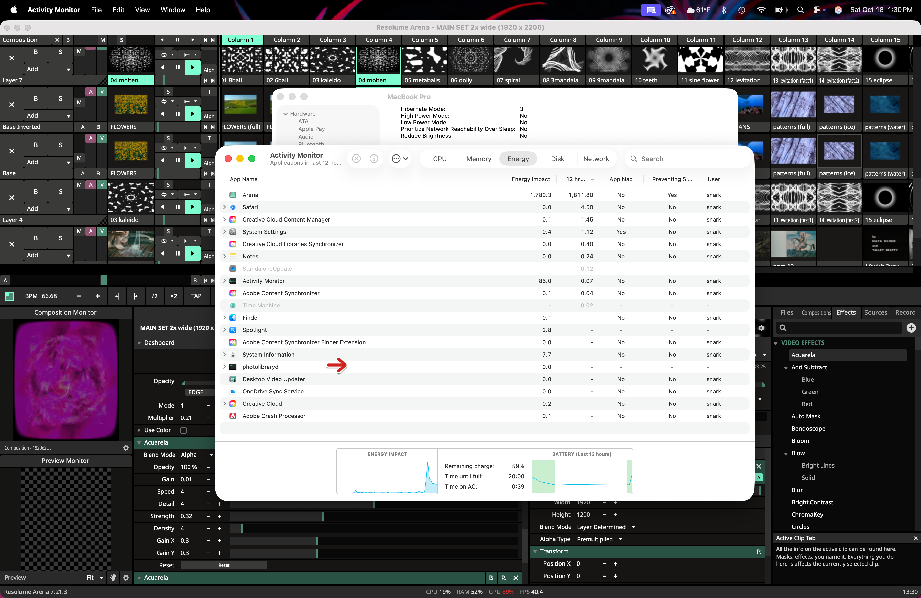

Just got a new 14" M4 Max. While running my effects-heavy composition, the battery slowly drains down to zero while plugged in to the original charger. Apple engineers blame the software, which I find to be ridiculous. The hardware shouldn't allow it to pull more power than it can take from its charger...

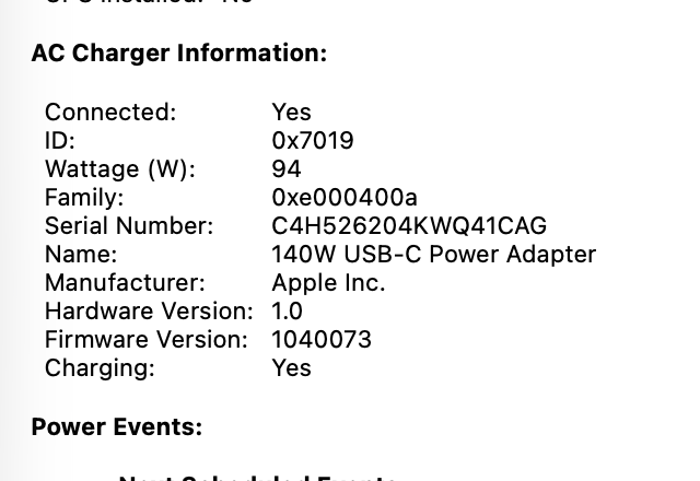

The 14" comes with the 96w brick, which in System Report pulls 94w. I tried purchasing the larger 140w charger, but still only 94w is drawn, and the battery continues to drain.

Screenshots of power draw:
Screenshot 2025-10-18 at 12.54.09 PM.png (34.36 KiB) Viewed 1597 times
Posts: 7771
Re: MacBook battery draining while plugged in
You can try limiting the FPS in the composition settings to 30, or 25, less work to do, less power use.
