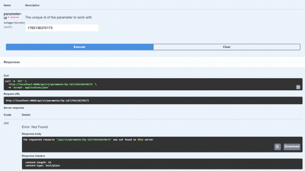

Using GET composition/clips/by-id/{id-number}, gets it correctly, but if I put the same number using GET parameter/by-id/{parameter-id} I get:
The requested resource '/api/v1/parameter/by-id/{parameter-id}' was not found on this server.
what am I doing wrong? I guess maybe clip isn't a parameter, but any id number of any parameter I'm trying give me the same "not found" error.
(Also PUT, and any other parameter for that matter)

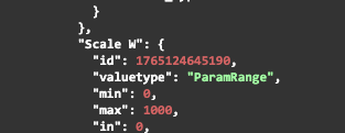

Clip by id is the whole clip, param by id is a single param.
Try to get a clip by position,
You'll see some Scale params in it,
They all have an ID like this:
Képernyőfotó 2025-12-07 - 17.32.07.png (10.61 KiB) Viewed 68604 times
That's the ID you can use for the parameter by id get/put

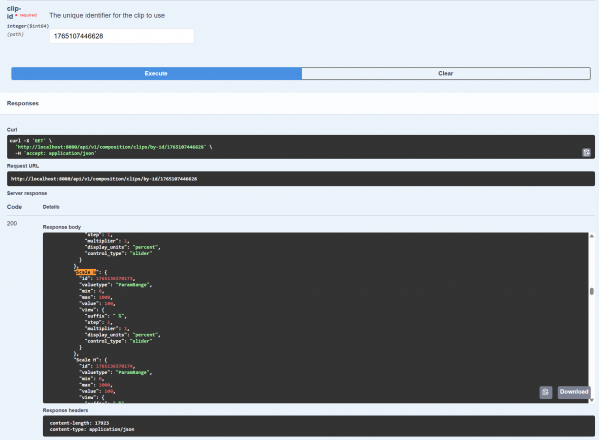

Thanks alot for trying to help and resolve my issue, I thought that's what it is but still the get parameter doesn't
Can't figure out if I'm still doing anything wrong.

Interesting, works fine for me,
Which Resolume version are you using?
