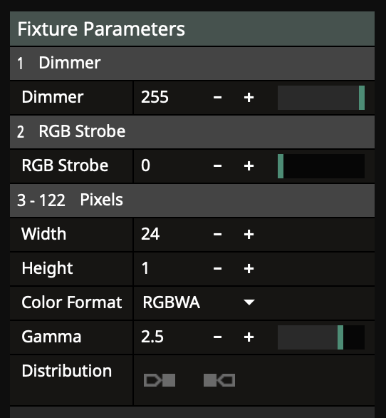

Is this problem resolved? I have an RGBWAUV 24-pixel LED bar, and I’m unable to work in Arena because I can’t add a dummy pixel within the colour-pixel parameter.

No RGB color. I would like the ability to add an empty channel for the UV and be able to use the fixture (24-LED bar) without the UV. But, as someone mentioned in a previous post, the only way to do this is by creating 24 fixtures, one for each LED (which is only feasible for a couple of LED bars).
My ledbar has 148 DMX channels: 1st for dimmer, 2nd for strobe, then 6 channels for each LED (RGBWAUV). If I do it as shown in the attached image, the second LED’s DMX channels are shifted by one channel, the third LED’s by two channels, and so on.
