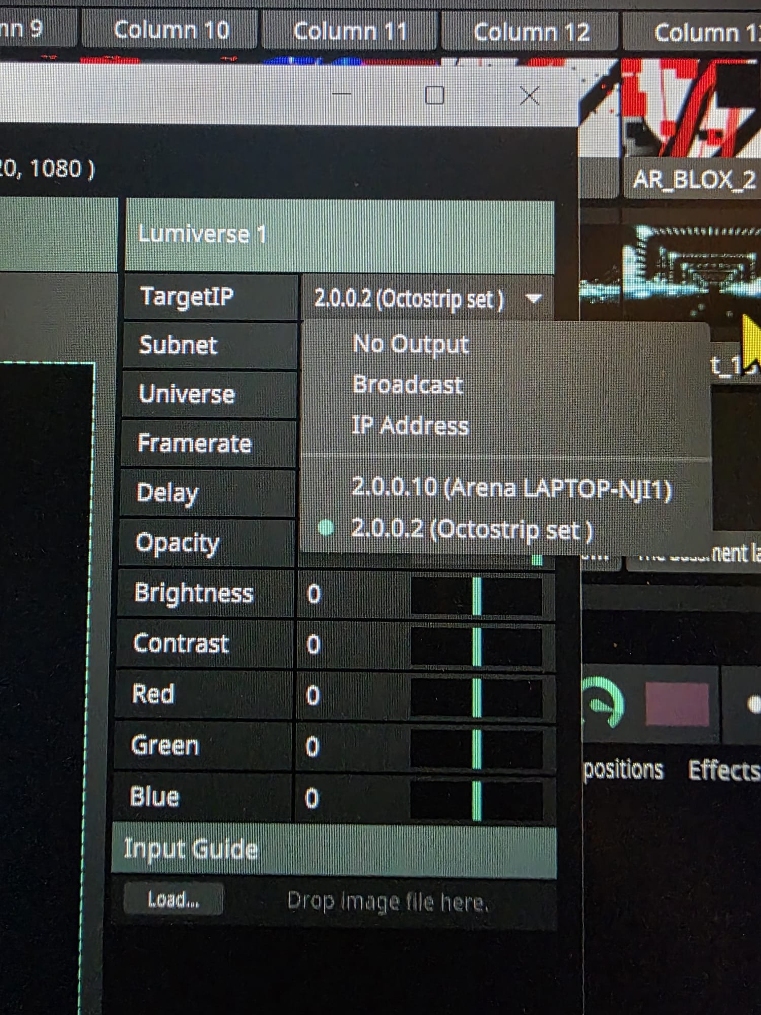

Hi, fairly new to resolume so i am having issues using artnet, i am using the latest version of Arena 7

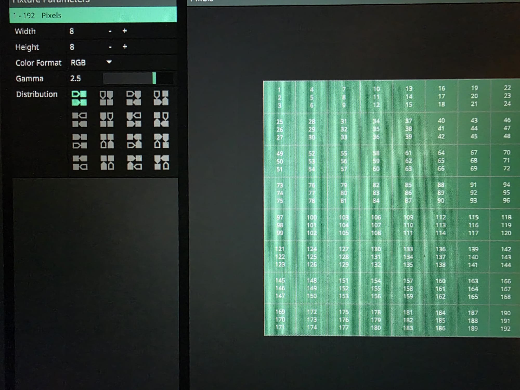

As i understood it should be possible to translate clips into dmx values over artnet driving my octostrip MKII by showtec that is artnet capabel I mad a fixture inside resolume, a lumiverse and did all the network settings, so the artnet node shows up in resolume, but somehow i am not getting any activity in the lights, am i missing something ? Tried several universes and setting but no luck.
any help is appreciated !!!

Check in preferences > dmx, that the selected interface is correct. Arena will only output on that network even if you specify an address that matches a different network on the lumiverse output target IP.
Can you post a screenshot of the full advanced output window with the lumiverse output selected. it's not clear if you've added a fixture to the lumiverse and addressed it correctly.
