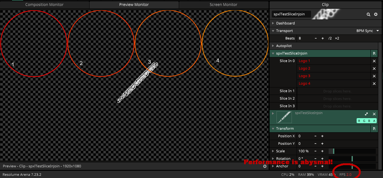

I have a scenario where I am trying to join lists of Slices, as well as other signals(/events) that I have "Expanded" to match the number of each list of Slicers, but when I use those resultingly joined lists as inputs to a Slice Render node, the indices of slices and their corresponding parameters (eg textures) are not reliably in sync, so I end up with wrong textures on slices and other similar problems. This can happen with a small number of slices as I add them, or when I delete slices from existing lists of slices.
I also see a few (not sure how many) frames where not all my slices get rendered when the effect is first applied.

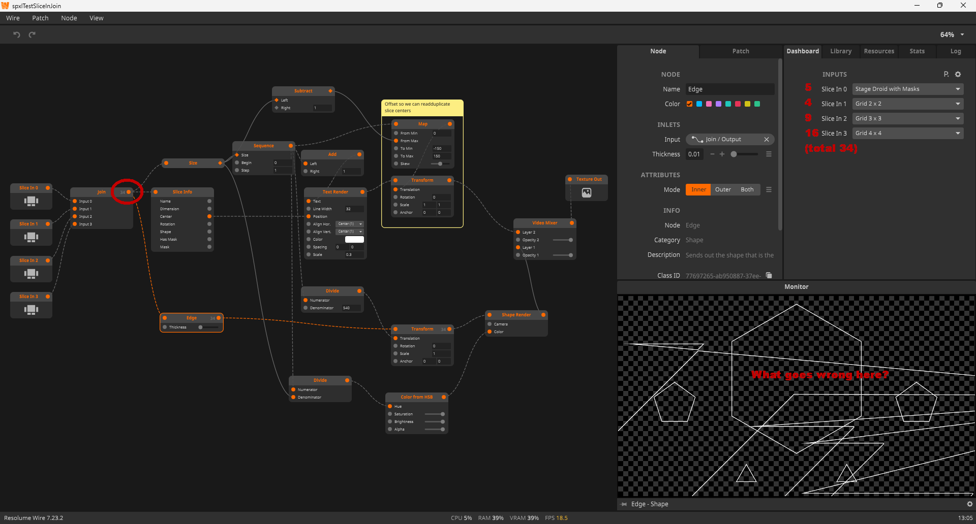

4x Slice In nodes, total 34 slices.
The Edge node sometimes draws a triangle that doesn't exist in any of the demo slice configurations, and sometimes makes this mess.

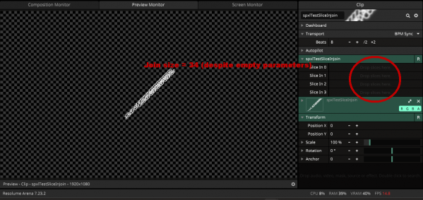

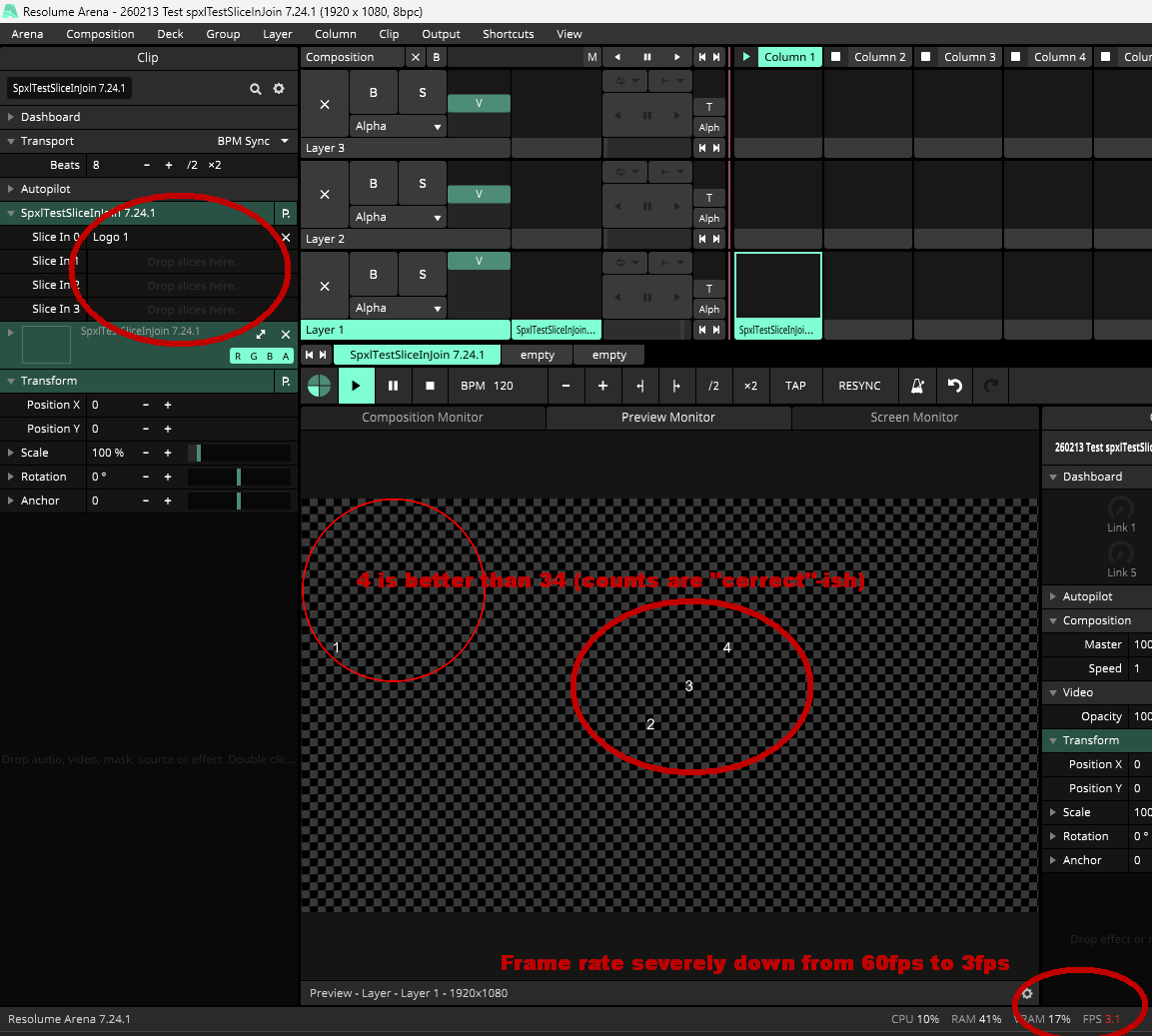

In Resolume, the demo slice lists don't exist, but Resolume still has the counts of the demo slices. Here I see the Size node must have returned 34, not 0, and not 4 (I discovered that empty Slice In nodes show up as a single slice with dimension 0x0).

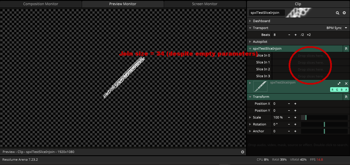

Adding some slices to the first Slice In shows that you can have a combination of real and phantom slice counts. I hazard a guess that this is what was happening in my much more complicated patch. More testing to come.

Wire 7.24.1

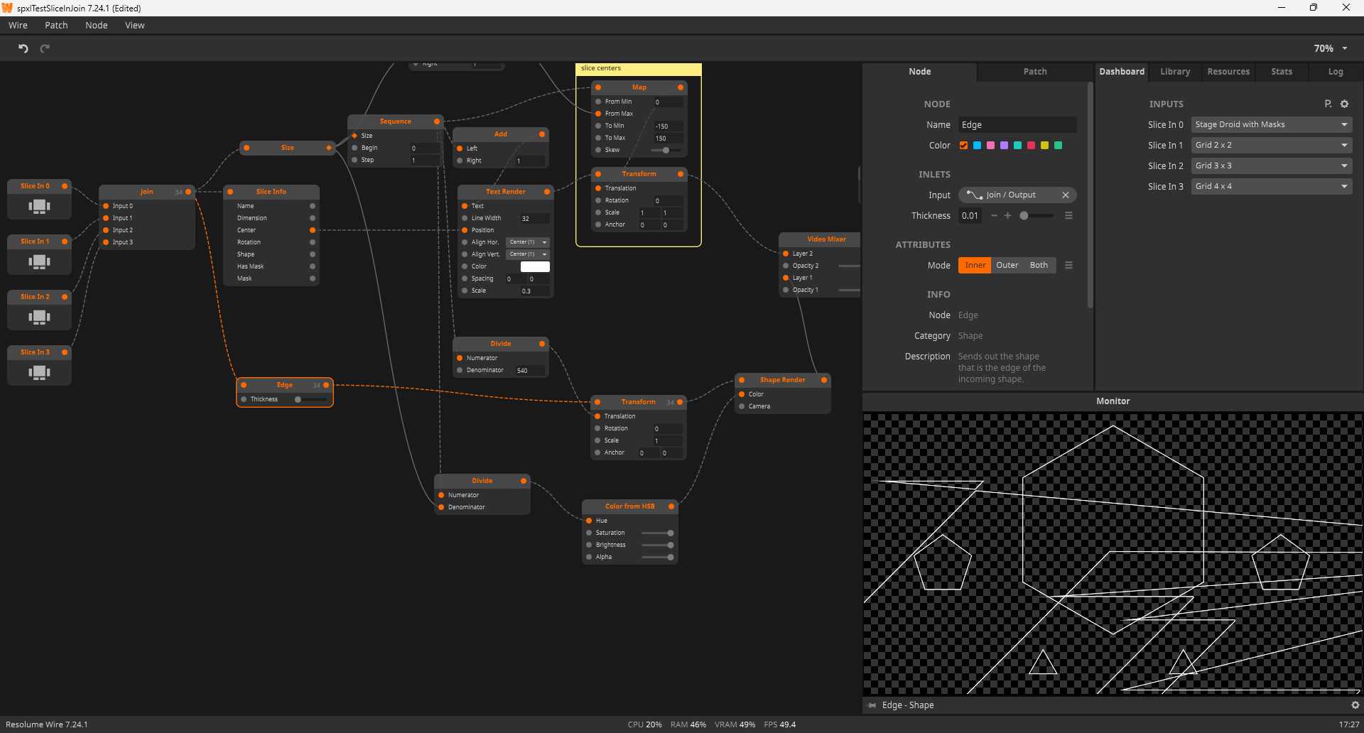

- On first load it was showing the mess of incorrectly joined edges. Seems to occur only if the "Stage Droid with Masks" demo set is used in combination with a different set; displays correctly if all the masked set
- Still crashes when changing Slice In demo sets

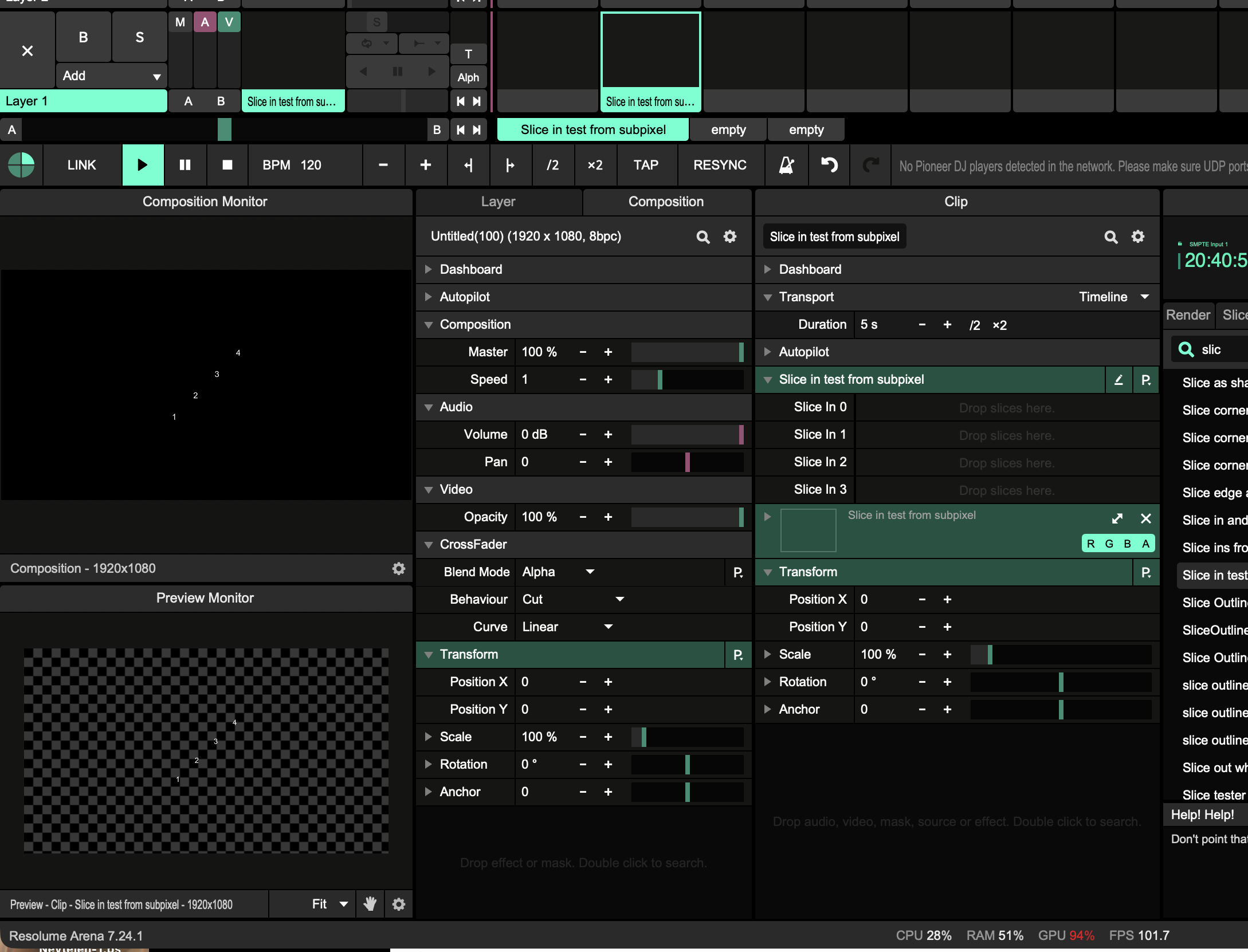

Arena 7.24.1
- Slice counts are now correct-ish (empty Slice In parameters still emit one slice instead of zero)
- Adding a single slice in the first Slice In parameter absolutely tanks the performance (from 60fps to around 3fps)
Fresh copy of nodes from Wire 7.24.1 (but loaded from copy of 7.23.2 patch)
--begin-wire-patch--
3389.3oc6bj1bahk7uhK9Lv7tOxmVc4cms1YlsljZ2spLt1BIv1rACZ.TNlT4+91O.g.IDfrsxXmXGWJ3m52Ue2ute7YqUIwwAqxCShyrd0a+r00oI2AOfrsR1judSt0U1V4IPKDaqU25A.Ggrt5K10Ph6ARbKHIG.I01JLtngdAiaaVl4dgwAos.kuETTMrLaqrv+HnEXvzrJHN2z4JnD1VqSxBMa6VPJ6YyPZAopGHosfTb.jX7312XYWvgObQhUcNfnCQOFHyS8hyh7NXySvc.u115NO.0E5E0BX.Ou1KG9h3cH.R0p.MDQpFx8XPHc.JrntcSa5IV08BM6Vu0ACN2rNWkllO.Tfww70N248wA27cyKS6Xkh6gDvOf1p6Zb6ZAf5be0Ejhtw.hCWqhNY.0cfp3cRQw3d.0HPcU0y+RpOHd9pOacSZxl0fpnO+Eaqzjj7RsRwI9AVuBYF4xGw6dTt6Q0WfI25tfbOyP4sI+1DXPsx1rbc3GChr.ITfW9ljzOYZMYS5p.nM+f0QIe5NPCwa7RuIH2z2k.AZ0s.Tv2G6cGL1V+6vTCzuOHMyP1.fty6+YFePd7tvXySFxMfsMcD8kuXF4rUogqKHyECkeX15HuO8yki3qW+wn2Djk+5nvUA+X7eOIL9BoKg4hAPC8gET30gFzhkOxmy3z.m.Ji5vHHOGkGh534wvDeNgPXBnOlwINK3xvnfx4qpgp4yxHKGFAOkFjkDs4tf+xVTSl6JffA60j7.yVKO3i4k8v7zrjnjzeL1O3i.luroWCJY+oMQ4gqiJVhTX6ljFdSXrWziHZjXPi+9FunvbflQIJNvRVt5yq59sAg2bKLaXjBDA9PneNzOrl.bKVYduO3AuZX0qFrY0je6l6VFWhGgttI07vs44qe0u8C+1OrOB88Aw9ELgu9e9e9GVP2iAj2OCbq+nOLzR6BNWC+tEpfmMOOMb4l7xltNJ4CETiOs1rXK9SXH8h1X9yrva.jsYLCiyxgsVYmp.NDL3cCPYpgmaV7KS1D6m0DsoH6PZT.AZHwHnMC5Vavgqh7xJ5QHrhsjRgVRDbm.A9ZfSbExQgIdNH+UdHVfjwEjlHTRwHjr5cPeeOvSmXDBMrSl8C7ivCgJZpXKjWNQEpb1sUxLrw61HuMdSTjcGebkYGdanOH4.PsEcsC4bUMYuPh6heL9BybWSP+uuOLKboQ1IOcS.LV3yLIgcxjDNh7bgjbOnF39oFcPNLBzIoNkqp5UWw+sip.SsGXsAFhwS8fs6.ipQK3lz.h+nI2TVgQs7B69iYMaF4rUdQANiZetLIIZWWFKNoguHirOcxzVvoVq8kWx0RTXWpfhnRLRSk7R0JBgq.3PkLFlgDD9w4n0DB2ggPZG8bxbG9kJsZglMaFk1jildO3nKwnsYFL6tc7zPPPnqr+l3yq1xS2j3Vy+Nrl0mbebUCIo8ogM1Ovd+g9uq1JP0KqB1FCn5uE97p8z4zXaWneY2l1nV194vGW0VK22Mx7sr+1zBh8Nqw014ZZCaeqT6wQzkQoVVc5vnxNq8uw7UWmjdW+F64cXrOBLPahSqOirFWVuNLJ5n7sW6EkYlgqShycJNqnip+.q+hcUnP677AVQw2zvp3ub80YA4WjkbwGBtXkW7EoAd99af3hLAadQgmRWTd9SYGw1IUqpscR3ascxwElKwDsqVHIblfpDRrR1iAS5L7bGlPN2YhjPbPWNiKDbphJYMMXh60foOZEFK2yfYaloZJQExtI5rBksih+WMwz2O0VdH0d7tTcWQv+GGnGGy.cR43pCb5AP3tXtTyAeUXa84QpotHsTJUTBhh6ymGukZNRojNTYPfC6ZehilA+4JH12khkR9JE8w1c90oIqB72j5E8b0Yf7aCW8t3frr97FvE7jr7G.ayTDf58Rauz1Sr11yvcSyxEZ51oXcg+MA8qWU8jJj4FpYd1Fy74OjYjqBCQGqIZgpx7ghHc4XvJNlqFx9wKwLe9hY94ucx+jCZtwz.Aa9P+2Kwp9RrpOEhUU2kU17PHJoLHVQG+vzxRrXn3VWFl6Gr1XNne31lQdXjgfvxJKdigrgB5sVELXTw6xsFDHRwi8dvWl7rYax71Us66PgjgZCdZfA++99mpJ4cSR9G+FevDrr0tKWRb4RDGBeq3PoKCaSQbEbDWRkTDSzan2KlPDNL4bgiVwm3LkMmOeFEyldorocW18xtaAyjmga53ZTKFYfuM0qALkMz7Pd+LLsAen.gtUecmOARAF.WmjlWlWzOVQDJxLJ7rC11AHIeoACYyItXO09HRsqOlwWd5Q3oZwgug7PYO6.M36sOhN0FpM6VyXstut0tcndqtUM0gpmFovz7UW7qAw9E5eNtsBxCIkxl5nYjp93a6.djcfssCjQ1A81NPGYGvBS4Or4NmpxjavkS+gVUlB5wGYEQAwPUnUmgvt8cFpRJwgQ78bDlRtYofg8YdLHtJ1C8b2pqfx6SwMznrJOwDw2nFFO8IdfEC8QZHOcsCM8KD0Vf+PN+tXt6h+cONzJlvcB5lhzpeAbzWIIbJ6TEwMm5+dI73.XHUxcnwbLHP63AgazdfgPfyVTBWnn75hEPhztbBhHnCk5CzbN2go3KbTX5bGIRLG7.6xEJ07wm5idNtbz4OV1pJn7nyCmgdPh.aSOSA8cK8aGu87PCBoet6tpAmn025cBrfiUZ31MAmhnPlWN31SgM6wuVJdbzveBmhmf5JA1UsTv2FLAFQUtLpTPHH4.Gh2hESuzgMa9DmISDKb3BLSwH3KQyZcHdn6SvDFxUO47rDy2CyNGYe9+8pVTz9Wt0A1bLP1K2k6wtVeBC6wvcLVpN3Z1ICUTprWXJ+4K9audZ+xRjWrTburTnEL2JyAEBVP71tJHrcNGIU8JV8cfMB7e1VHn2et5sW1hSwXx1tLxT2TBeX7IOEgiN6SkGT4oJZN5ba8tfObJRwFvGaZsRNQjeUGNgg+jP7UcXTCe2ll4rtqIUsPPQpcdYh0HWpTS0L9.IWSSl6vPLlihLelybxBzbJZ9kR0hGpBj5aZzQEsonFbiGGLTGIt5bkim2E7gdVHEQYWxjziBKNplVebnbLf0klstzYruZgtE62WxtCI28x5v9xdMEu5R7osDRWR.sYx2on8m75ufoHrSUKaMr6beXbJlPmfD6AFm5AputthrsOC6LRMji1cDL0kvIaql8xD1qcIRIQQjFG2o8E2JzQsiI87NSmOagyzEWR3HHD3IDwCTkxYzQfWuYYdp2p79YR6nFNGaJtJk6VA3+7gn7mPcj7zN4ViO7Rg.zshHJjTf24GLSKcYPPlTMFioj9cEdBQhbXyEHG.5YNSTpo3oKDTgdxCsLQV9o0dsJDu8RFeQtFs+l3yN8H+Y+Mqn5549MzNZvRDFCRfm8eMqjj0dqBy+D97GoX0LQN2yTKyLMxEWkZf15xsOrdFeXokamMo+kQ8zE+T3GGJEbhu0O2kynyNEmROQxHZLDKTsoGhRXZELVpF7NJLQOwb1lSYNSwnKcnZgZJULcpfN8Q+PXNS2Efw4o6Yz+qI998xiSu+2mhN4DHnCYE3T0HSnpdN0ggmp.maAObIToBQtTQWnu7Qgf+0KCje0p7g9tlzWmzKouiHCWFbyfmiRCcFiUYX0KVjwOvCoZqLON4AqG6P1sGyHwA7pRHfrJMUbsKSwEbgjpFvGY1Rsmim7ZgonpCTBghesX0CsH.JnFCE+fAKbBZWZPgqSmQKxSS7ZCVpfeeSP7p9OQ2Nhhq90wzoXIbWmFUgcLV9vtuQcGFzDWhqXAnXRepqlHwDv9jl4nEKl6PmfmnkbwhIhIO35+n90X02dpr5jm3.pdEUsAKXkgtix9It+Ghf4NI12U2bRQMKdhGgPukQa0Z9oeUzl+oVEm+AnleM3lMQdGSEKgH5vyPL1UpEbjBz1VeRXLveQFhqYLEgQ52yvEjEybXWhm5nQ3INyVb4LljMmNC0pDZ42qrdOh6N7iUjW0SFrj+pLgemchK2.pPB+JbEVLySxWi7nbfar6IN9Vq2XtR01ee7eFLRDXxnRAyQQ9Th84+2qdo71+Sr71AoOCmPk189v9U2YgWd5Q5oFX+gjCejTBV+FY86m6W5SmaiIxkhJ9AabFUSTZg8Ks8RaOwZqfU1jWiCuHbeeb0X6J+JEg4V6U7N2VamqkVlR2S29i1UjpVg11PLabWZAW6FyMjRdleoapO4W5lBL6Y06A0Go2MpjdISpyLYBKNY5DPOd1SmNOjRZujR8ibxhZQhHkjHEA6xXD71WgYUuIPItHBx79ICzzOPsaOcwhINr4TkiZwBtCZwzIrYSmilrXwicVjdlWtCClIo2Tt+t3W1zWAbACylvhSst9RkCTRysnTS3Jhb2kxprFZ4BWljJ4LUYdUrs9iDyaAdjqPKDDFiKUTAliwFgrrfnsuTDdq4MnPw62WaKCsAqrLWTVy6e4hWMbEuM.KtYcEW.ohaNQQglWTGjE0YVQV8Mo8zj+KSJKLmarwVhQQkgCGvJ+e7k8T.H
--end-wire-patch--
260213 Test spxlTestSliceInJoin 7.24.1 01 Wire Edge failure with Masked and non-masked slices.png
260213 Test spxlTestSliceInJoin 7.24.1 02 Resolume slice counts correct-ish, frame rate terrible.png
I noticed this too, made a ticket,
The instances count can't be 0, because of reasons, so it's 1.
Polygon slices and polygon masks are heavy to render in Wire patches.
The no slices loaded low fps is interesting. Your patch is at 100FPS on my mac.
Can you attach the Resolume log file?
I'll make a ticket for the edge weirdness.

To correct any misinterpretation:
No slices: 60fps (capped by framerate of output screen)
1 slice: 3 fps.
I should mention that I can output a dozen of that same kind of slice without such appalling framerate, so something else must be the issue here. The Edge, maybe?
