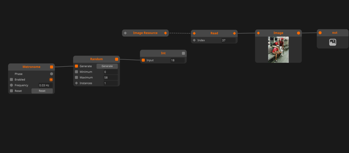

Hello,
I am trying to create a sequence of random images for some screens using Resolume. I have tried to do this with Wire, but it does not work due to the type of flow (attached is an image of my idea with a metronome and random). I have been researching and understand that it cannot be done with Wire, and doing it directly in Resolume would require More than 50 columns and it would become impossible to work with. The option I am currently using is a video of sequential images by Resolume Alley, but when I add more images or change the images, I have to create a new video. In addition to the fact that they do not appear randomly, I would have to change the names of the images to make them random.
there is another solution or any tip ?
thank you

Re: Random Slideshow resolume arena
Try Auto pilot in Resolume with the images loaded into separate clip slots: https://resolume.com/support/layers#auto-pilot
This one is random order:
