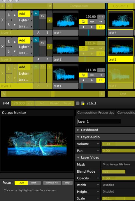

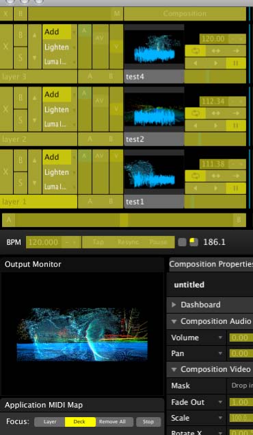

-Start the application MIDI mapping from the menu.
-Look for the Key Map box in the bottom left of the screen to select whether to focus on the currently selected layer or the deck.
-Choose "layer" and make sure all layers you want to map contain a videofile!
Hi GeeEs,
I was able to get avenue to display mapping for all transport controls on each layer, however I had to use Focus: Deck for it to work. Like you said each layer had to have a clip active and playing for it to register for mapping.
Using focus Layer like you suggested just displays the mapping controls for the active layer in my case in (image attached below) the transport controls are displayed on layer two instead of one, I guess because I had a clip selected for preview on that layer.
So It seems to work with either Composition Mapping or Application Mapping focus Deck as long as each layer has a video clips active and playing. Cool Stuff! Thanks for sharing your work around tip.
