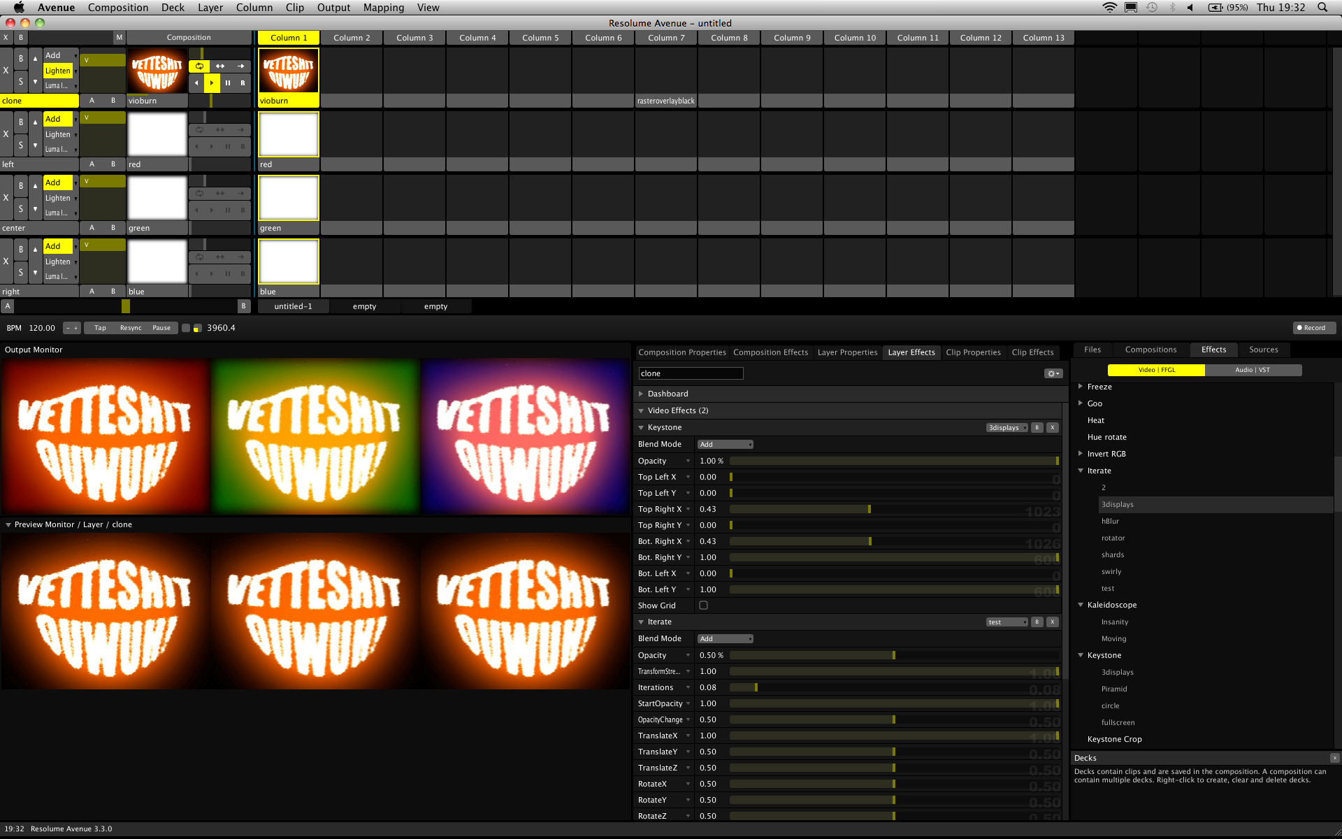

Re: multi screen Avenue setup
Thanks for the replys:
@HerrNieda
Good workaround that will work. Never thought of that, but a lot of work each time.
I could make a deck where all clips are 3x times.
And you're right about the bug today the bug wasn't there all the time.
@Ridiculoid
Took me a few hours to figure out the parameters but in the end it did work (see screen shot).
I added 1 keystone effect and one iterate effect.
There is one problem i had: The source video resolution/aspect ratio. When these change you have to adjust the keystone parameters again.
So i have to make sure that i render all videos to 800x600 (in this case).
So i'm still hoping for a effect that does this better/easier.
