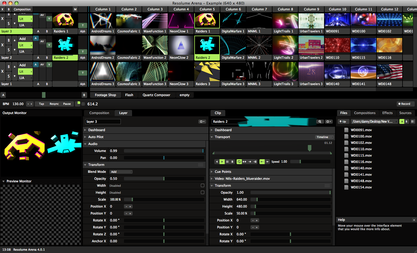

After looking at other posts and getting help from Resolume staff, I've figured out how to map multiple clips to multiple slices. The purpose of this is to have different objects showing different videos or pictures. And it works great, but i've encountered somewhat of a problem.
If I change the clip that's playing or picture thats displayed on a particular layer, I have to rescale and reposition each of those clips so they fit within the space that the slice input is looking for. see screen shots.

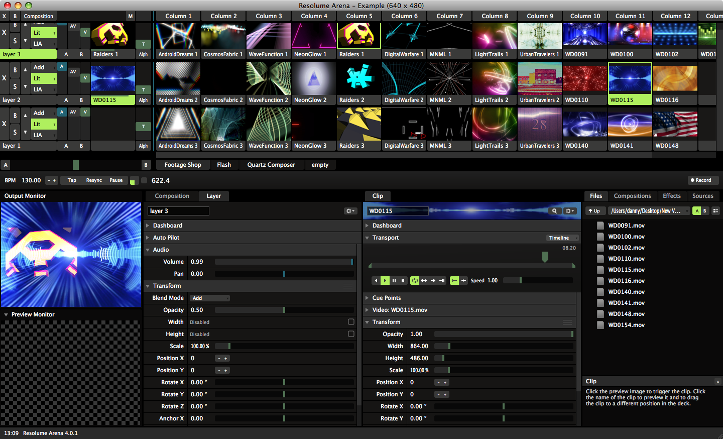

Shows the new clip added and overlapping one of the original clips (scroll down to output monitor). Now in order to have the slice that was showing the clip on the right in its entirety I have to resize and reposition the new clip to be in the same place as the old one.
Picture 2.png (619.06 KiB) Viewed 3167 times
Shows the two clips resized and repositioned, even though I didn't include the shot I created two slices using those two clips as the slice inputs (scroll down to output monitor)
Picture 3.png (758.1 KiB) Viewed 3167 times
Just as info, If I reload the original clips I selected they retain their position, but when i select a different one i have to reposition and rescale it to the same parameters of the previous clip.
Is there a way that i can set all clips loaded to a particular layer to all have the same position and size?
This would be a huge help, so I wouldn't have to go thru each clip and layer and position them one by one.

vj granda
Posts: 195
Joined: Tue Sep 28, 2010 11:34
Location: Andorra
Re: Multiple Layers, Clips, Slice Question
Post by vj granda »
You Can do it in the layer properties...
