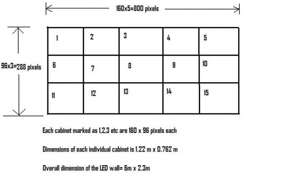

A LED wall is a combination of smaller LED cabinets(arranged like a matrix in rows & columns formation).
Each such cabinet has a resolution specification. If the resolution of a single LED cabinet is for example 160 pixels by 96 pixels, then a LED wall of 3 rows and 5 columns of cabinets will be of the resolution 800 pixels by 288 pixels.
(160x5=800 & 96x3=288).
Note: a LED cabinet with 160x96 resolution means that cabinet has 160 bulbs horizontally(per row) and 96 bulbs vertically(per column).
That means you will be playing your visuals on a 800x288 pixel screen. If you set your composition resolution in resolume same as that of your LED wall, then your clips inside resolume will be rendered at that resolution. So before creating your content its important to find out the screen resolution upon which you will be working at the event. Hope this helps ;)
In your case you have to find out how many pixels horizontally and vertically is your 4m by 2m LED wall is coming upto.
In the example jpeg i've provided each cabinet is 1.2 m x 0.762 m, so the wall is coming upto 6 m by 2.3 m
