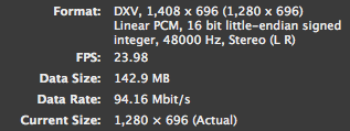

Ironically I used that method to remove the audio over a clip that was annoying me during testing earlier today (I rarely have audio hooked up during performance, at least, not with resolume) but it hadn't occurred to me to try it on that clip.
I tried it and it seems to fix the problem completely!
Is it likely to be an encoding issue then? It doesn't look like a very exotic codec to be honest.
Clip Properties
Clip Properties
edit: I just checked to example footage and the only difference in audio (other than the fact that it's two separate files) is that T3_B.wav is 44100 Hz instead of 48000 Hz.
I didn't get any freezes with the example footage by the way.
