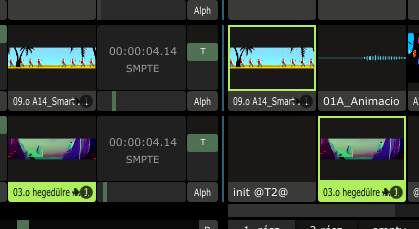

gabonacorp wrote: The clips in Arena can use the timecode only if they are selected but in this case I have to fire 5 different clips at the same time, all of them are using the same SMPTE, their lenght is exactly the same, etc.
works for me.
select clips individually, set transport type to smpte, launch them and they are all synced on start/stop restart.

Yes, if the clips are already plays then they can be syncronized by smpte, but the main question for me is how to trigger all the clips via smpte timecode at the sme time. If I select a clip than I can set the start timecode for trigger so I can use the incoming LTC to trigger my clip which is needed in my case because The media playback should be sync with all the other showtwchnical element (lighting, sound, pyrotechnics, etc.)
edit: I see what you mean,
but resolume will not trigger anything on smpte, you have to trigger clips yourself, or software.
your clip will start playing if timecode is valid for the clips' setting.

gabonacorp wrote: Other question what cames up in my mind that now I can set timecode mode to a clip only if I have a valid timecode. Usually I set up everything in my office for the show weeks before the date and in this case I need a valid timecode during the programming session which usually I don't have. Can I ask what is the reason for this limitation?
I can set the transport to smpte without having a valid input, of course the clips don't play.
