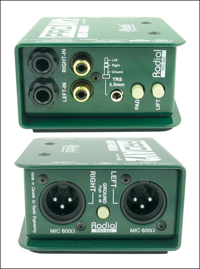

You probably have introduced a ground loop in your setup so to get rid of the hum, you'll probably need to use a stereo DI box (or two mono if you have them already). I personally use the Radial ProAV2 and they work like a charm (http://www.radialeng.com/proav.php).

I took a look at the DTI unit and I think the Radial Engineering unit might have a few advantages such as:
  • 1/8" TRS input
    Input through
    Pad
    Lift
    Ground Lift on output side
