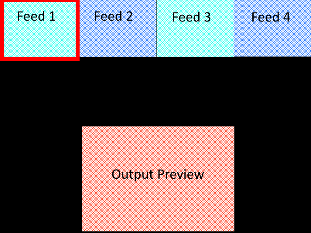

I would set this up similar to drazkers. Lets say you have four video feeds. I would use one screen for controlling resolume, another for preview and the last one for your video output.
Composition Layers
1. Output selector: LR6, LR5, LR4, LR3***
2. Preview selector: LR6, LR5, LR4, LR3
3. Live Feed 4
4. Live Feed 3
5. Live Feed 2
6. Live Feed 1
7. Red Outline for Preview Selection. Scaled to 25%.
LR=Layer Router. LR6 would be Layer router for layer 6
***Each clip in layer 1 has the Visution IR OSCSA effect applied to it. This effect sends an OSC signal to adjust the X position of the red outline on layer 7***
Advanced setup
Screen 1
This is your main monitor so will probably want to use it for controlling resolume
Screen 2: Output
Slice 1
Full Screen input and output. Just to be on the safe side the input source should be set to Layer 1 instead of the composition.
Screen 3: Preview
Slice 1 - Red Outline
Full screen input and output slice. Input source is layer 7
Slice 2 - Live Feed 1
Full screen input, Source is Layer 6
Size 256x192 (25%)
Position 0, 0
Slice 3 - Live Feed 2
Full screen input, Source is Layer 5
Size 256x192
Position 0, 256
Slice 4 - Live Feed 3
Full screen input, Source is Layer 4
Size 256x192
Position 0, 512
Slice 5 - Live Feed 4
Full screen input, Source is Layer 3
Size 256x192
Position 0, 768
Slice 6 - Output Preview
Full Screen input.
Size 512x384 (50%)
Position this somewhere under the preview slices
How it works
On the preview monitor you'll see each of your feeds on the top and your output on the bottom. You can select which feed you would like to send to the live output by clicking on a clip in Layer 1. When one of these clips is clicked, IR OSCA sends an OSC command to adjust the X position of the red outline.
There are a few more little details that I skipped and the numbers have been rounded to make it easier to understand. It is possible to achieve this using column triggers instead of IR OSCA. I can explain if you'd like

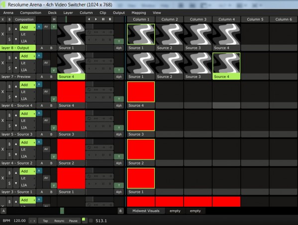

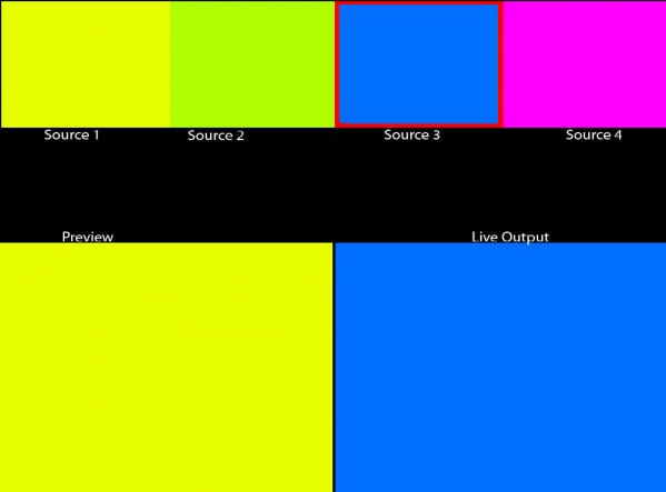

Re: Multi-Camera Setup / Previewing multiple Sources
I went ahead and created the composition. It's different than what I described. It has a large preview window in addition to the live output. IR OSCA doesnt allow for fine values so it wasn't possible to have it adjust the X value of the red outline. I created four clips with the outline, each at a different position. IR OSCA triggers the corresponding outline clip. There is a layer to select the source to show in the large preview area.
You'll need to install IR OSCA and enable OSC input within the preferences window. To get this up and running relocate "4ch video mixer.png", copy 4ch Video Switcher.xml to "Documents\Resolume Arena 4\presets\screensetup" and replace the clips on layers 3-6 with your inputs. I'd suggest replacing the media in the clip instead of the entire clip.
Please note that I havent done any testing beyond what is in the composition. Feedback and modifications are always welcome.
***Edit The screen setup (mapping) file was missing from the zip file. It is now included***
