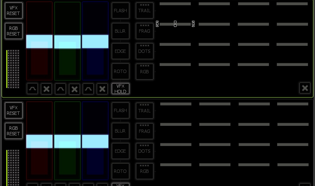

I downloaded the files you had in the first post and cant seem to get the vfx bank to load into Resolume as you have in your demo.
Im running Resolume 5.0 and Lemur 5.3.2.
I also dont seem to have the sequencer buttons on the ipad interface.. Just small grey bars.
Any ideas?
Thanks

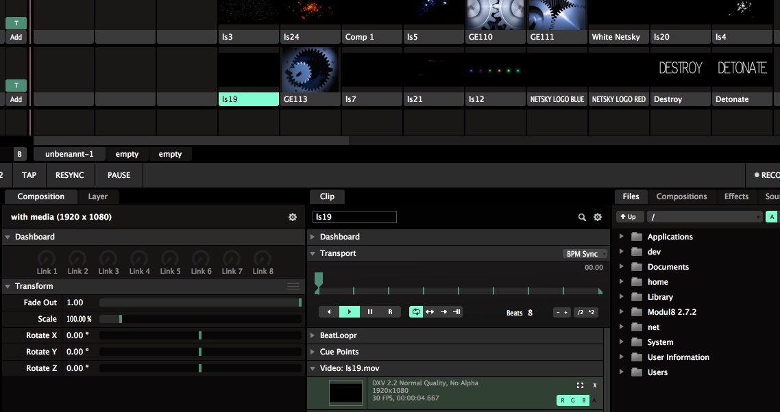

Hi Cosmowe.
AS per your q's
Im running an Ipad Pro
Im running Resolume 5 and the pics are as attached.
I used the files as per your original post
If you need more info let me know......
Thanks
Matt

Posts: 1627
Re: 4U Resolume step sequencer [Lemur]
Seems that you ran into an iPad pro incompatibility. I would recommend you to place an email with your screenshots and your problem HERE!!!
The grey bars you see on your ipad pro are decorative elements I added underneath the sequencer buttons to make them visually separated in 4/4 bars. So it seems that the whole sequencer module is not able to be loaded at all.
Do you have an typical iPad to make a reverse test?
So.. you also wrote that you don't have the video fx inside Resolume which I pre added in the demo *.AVE
You will see them when you extend the [Video Effect] Tab in Layer 2&3.

Hey Cosmowe
Thanks for the info.. Ill give the reverse test a go in the am, but yeah Incompatibility was one of my 1st thoughts too. :x
I see the effects now yay.. Thanks for that point. I was expecting them to be on the master out....
Ill flick liine an email too..
Thanks for the help.
Matt

Happymanners
Posts: 4
Joined: Wed Feb 03, 2016 03:26
Post by Happymanners »
Hey.
Ive put your module into my ipad3 and still same issue. Thought the iPad pro may of been issue but no.
The screen is the exact same as the screen shot I put on the thread from my iPad pro.
Meh!!!
Any ideas?
