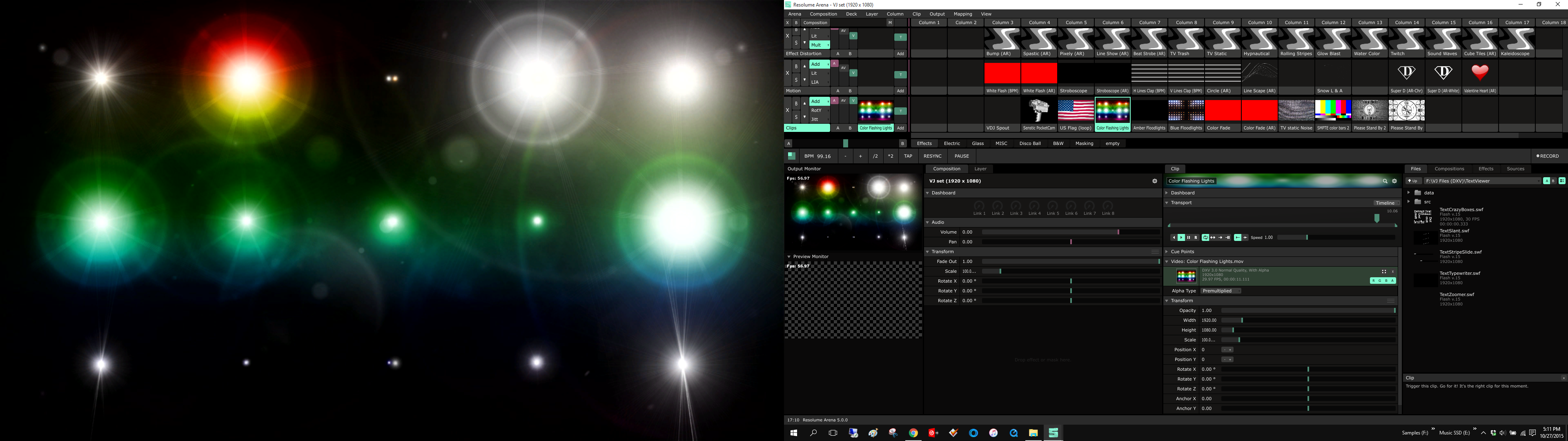

So I have been through screen tearing before with Windows 7 (Aero was the issue). But I just can't seem to figure out what can be causing this in Win 10. I have tried the latest 2 NVIDIA drivers 355.98 and 358.50 (both were Win 10 installs). I also have the latest Intel video drivers too with no luck.
Basically I have and ADK laptop and they specialize in Pro Audio / Video work. They have a very good video guy who has remoted in to help on several occasions over the last 2 days. He is saying that there is probably no way to eliminate this without re encoding all my videos into DNxHD. I personally believe this is more of a Win 10 thing, but looking for help. All my content right now is in DXV 3, as recommended. I have a couple SWF files too.
First off, he asked what Quicktime API was Resolume built for? He suggested I go back to that version of Quicktime. Also was just the UI for Resolume updated for 10? Sorry for the direct questions, but this is what I was asked to find out. I also noticed that there is no "Win 10" version of Quicktime. Not sure what to do here but gather details and pay attention to the specs of things.
I have also tried going into the Exe properties of Resolume and Quicktime and set (individually and both) to Compatibility of Win 7 or 8 (Resolume was not happy with 7). As well as Admin modes.
I saw some posts about Win 10 Game DVR causing Tearing. Previously I was not logged into the "Xbox Live" app that enables this. But the hot keys still worked. So I logged in to disable it. The hot keys don't work anymore, so I think this is a non issue.
Theme, I am using an "Aero" type theme. I have also tried enabling and disabling transparency for the Aero theme. I still get tearing after all this.
I did install 10 over Win 7, but I went back to the clean factory image of this laptop and got all my updates before doing so. Then once in 10, I updated all of my important drivers to 10. I may update everything before reverting back. But basically this is my last chance for 10, I am pretty savvy with PCs.
NVIDIA set as video card under NVIDIA control panel (confirmed running with GPU Z). V Sync off, Max Performance power. Clean installs done to remove the Win 7 drivers before it.
Any help is greatly appreciated! Thank you!

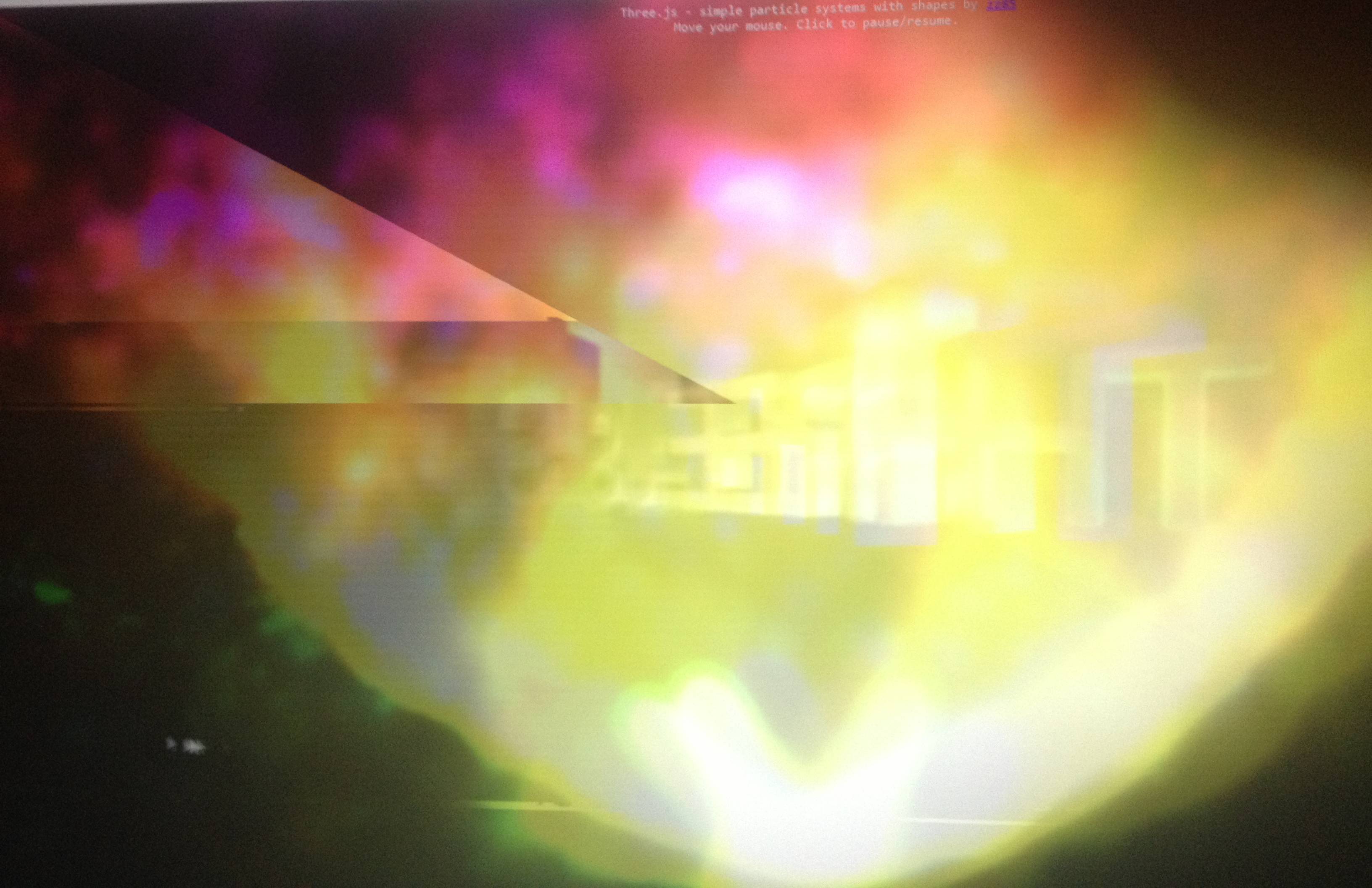

I have the exact same problem after updating to windows10 - diagonal screen tearing. It also happens in other programs like Firefox, even on simple text+img webpages (tho not as strong), which to me proves this is not a codec problem, rather something Windows or Nvidia related.
Running a Geforce GT 750M in a Dell XPS 15 (2014 model). Using internal graphics prevents screen tearing.
As going-back to windows 8.1 is not really an option for me I would rather appreciate any help in fixing this.
