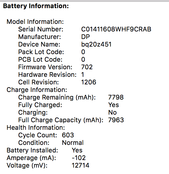

It could also be that your battery is bad so check out the condition of your battery in System Information>Hardware>Power. Here is what mine looks like:
Screen Shot 2016-01-04 at 09.49.02.png (82.77 KiB) Viewed 6473 times
Another thing you can do is to power all your USB devices that draw power from your computer (Matrox, DL adapter, etc..) from external 5V USB adapters
