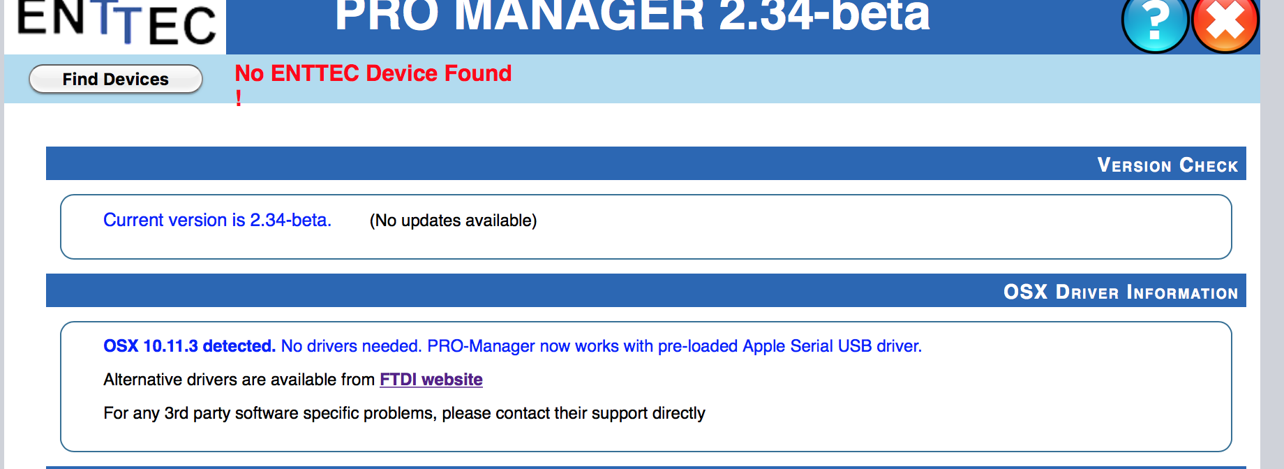

Right I understand that Resolume 5.01 is having problems with Enttec DMX USB PRO Mk2 but the problem I am having is that my Enttec Mk2 box is not even showing up on my Enttec Pro Manager software. The enttec box is connected as the white LED blinks.
I'm running ElCaptain 10.11.3.
Has anybody faced this problem? suggestions how to fix it?
I tried the D2xxHelper but it didn't work.

@ Alvis_Cortex: Did you check out the Enttec website: http://www.enttec.com/?main_menu=Produc ... 4&show=faq under "OSX El Capitan: Update"

Thank Oaktown.Oaktown wrote:@ Alvis_Cortex: Did you check out the Enttec website: http://www.enttec.com/?main_menu=Produc ... 4&show=faq under "OSX El Capitan: Update"
I did check Enttec website and I downloaded Pro Manager 2.34 and I also tried entering the following command to Terminal
Code: Select all
sudo kextunload -b com.apple.driver.AppleUSBFTDI Thanks
