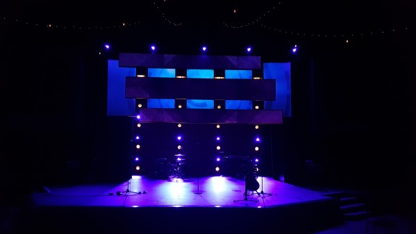

So, this project probably isn't super interesting for you veterans, but this is the most complex mapping thing I've ever done. Only been doing mapping with Arena for about 2 years maybe, so I'm still decently new. Anyways, onto the project. I'd love you're guys' input on what I can do to make my composition/output better. So, here's the design:
This is being projected on with a single 16K projector. In addition to this, we also have two 8K projectors as side screens. The center screen design is a two layer thing. So the 5 panels in the back are sitting roughly 6 inches behind the 3 horizontal bands. The way I've mapped it so far works fairly well. I'm limited a little bit with what I can do, but not a ton. Only issue is, it uses a ton of layers and layer routers. I've got 20 layers going so far and to add more functionality and options, I could easily double that if I keep going the way I am now. Also, right now I don't have control over the side screens. I'm just doing the center screen.

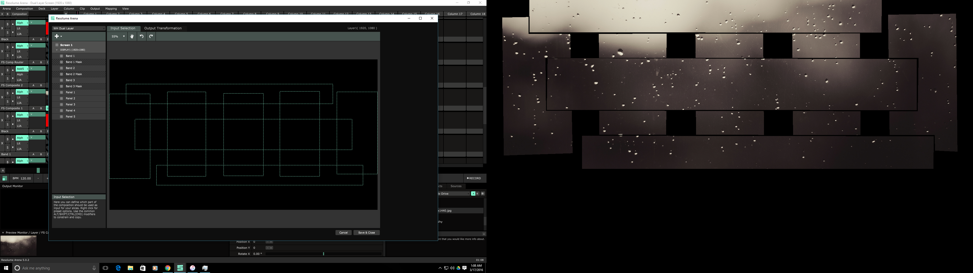

Now, here is how my composition is currently setup. Again, right now just the one output for the center screen. It's 1920x1080. It's setup with 20 layers. The bottom 8 layers are the "outputs" if you will. I've got 8 slices that take these 8 layers directly as their source. So I have a layer for every panel and band. That takes care of the need to have something different on every panel. It does not, however, fulfill the need to have blended video on every surface. It's just a single layer for each surface.
Next in the chain I have 3 blocks of 4 layers each. In each of these blocks the bottom is a layer for a black solid. Then 2 layers for blending video. Then a 4th layer that houses a layer router using the "layers below" setting. The 3 blocks are reserved for a full screen composite, a panel only composite, and a band only composite. That takes care of the ability to have blended video on the panels together, the bands together, and the full thing together. In the 8 layers at the bottom, I just put a layer router that routes to the top layer of those blocks where I need them.
Here's a screenshot of the advanced output screen and the actual output:
I hope that all makes sense. I'm thinking there's a significantly better way to do this. Maybe using more slices in the output settings. The trickiest thing about all this is retaining the ability to use blend modes and composite video layers together. If I didn't need that, 9 layers would cover everything.

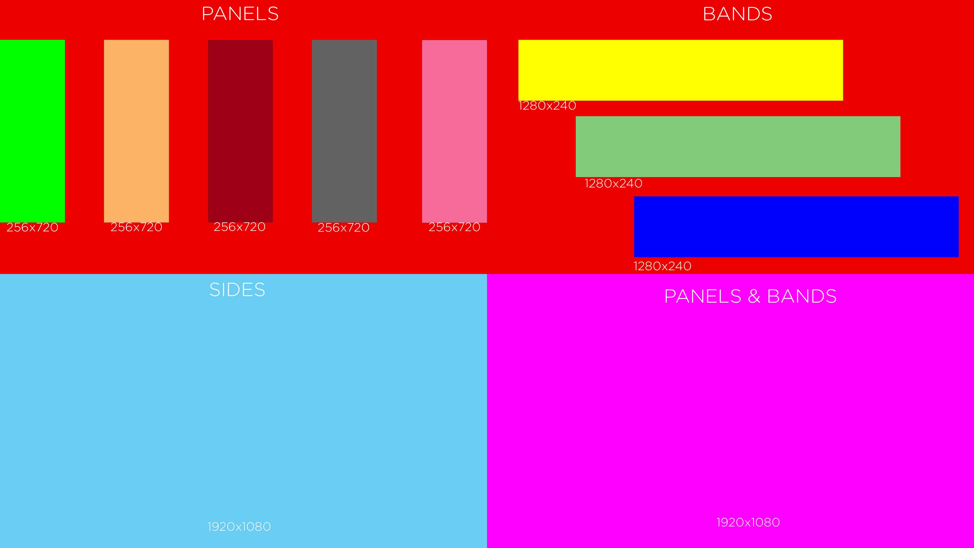

Here is how I would layout my composition (of course sizes are arbitrary):
This is based on a 2x2 1920x1080 comp which is 3840x2160 (4K).
I would create both Photoshop and After Effects documents with masked layers if you want different media for each panel/band. That way you can quickly render media (stills and video) to match this artboard.
This should let you do everything you're describing with 3-6 layers and let you manage the negative space (red in the png file) in your composition.
