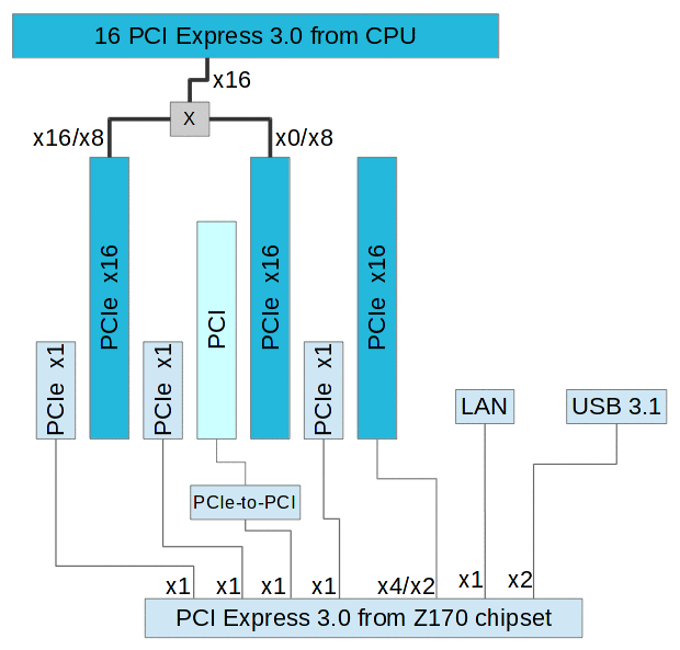

Re: Advice for hardware setup to display 11 outputs
It sounds like you're putting your MB through the ringer.
I believe the Z170 only have 20 PCIE lanes available and from what I could find, here is what your board PCIe lanes look like:
It looks like your PCIEx16_1 and PCIEx16_2 are via CPU whereas your PCIEx16_3 is via Z170 chipset so it's possible that it introduces some instability in your system over the long time.
If you're going to be using 3 GPUs for a long term project, you should definitely get a better MB with 3 PCIEx16 that can run at least at x8 but preferably at x16 AND three matching GPUs.
