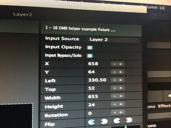

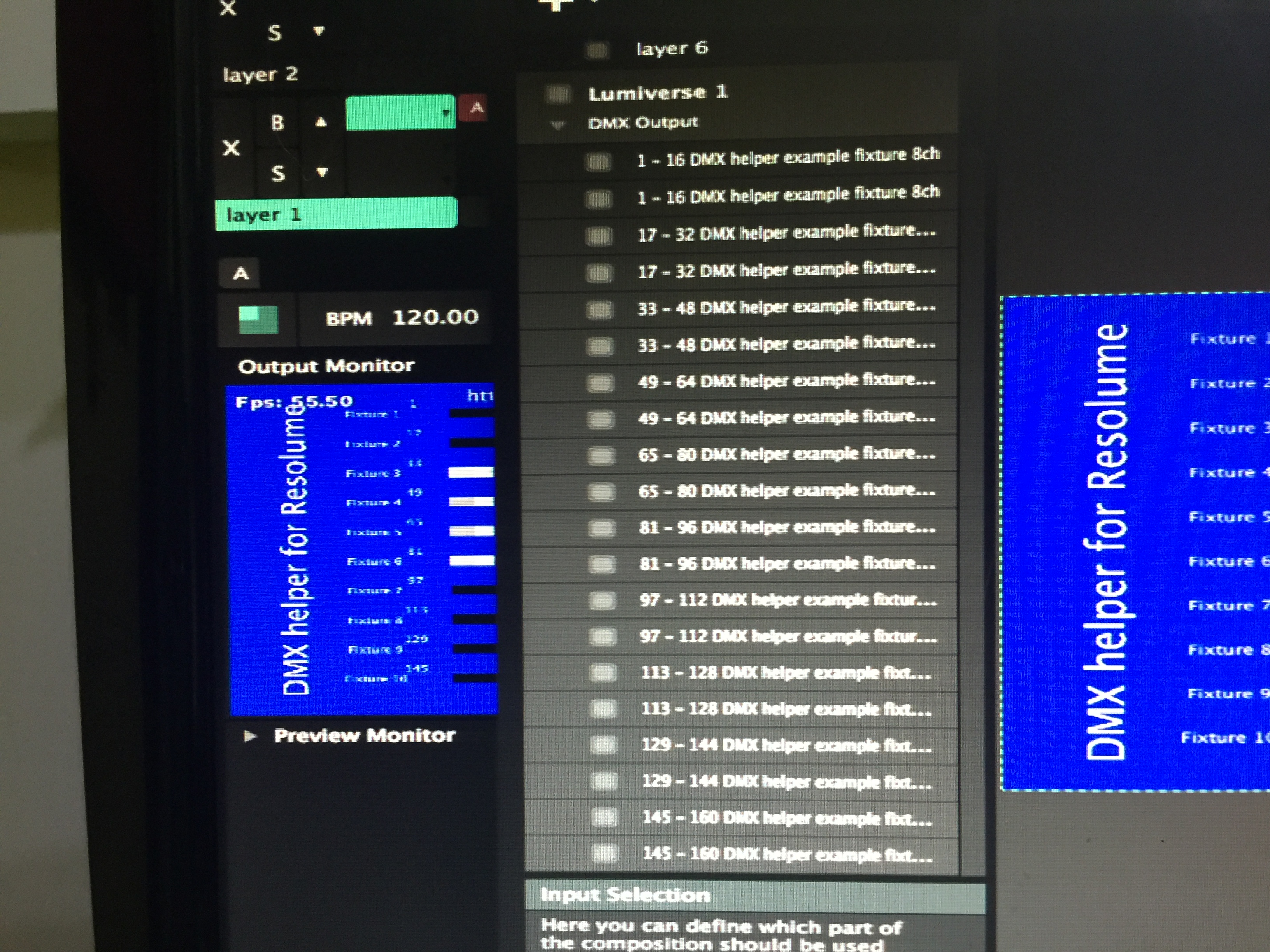

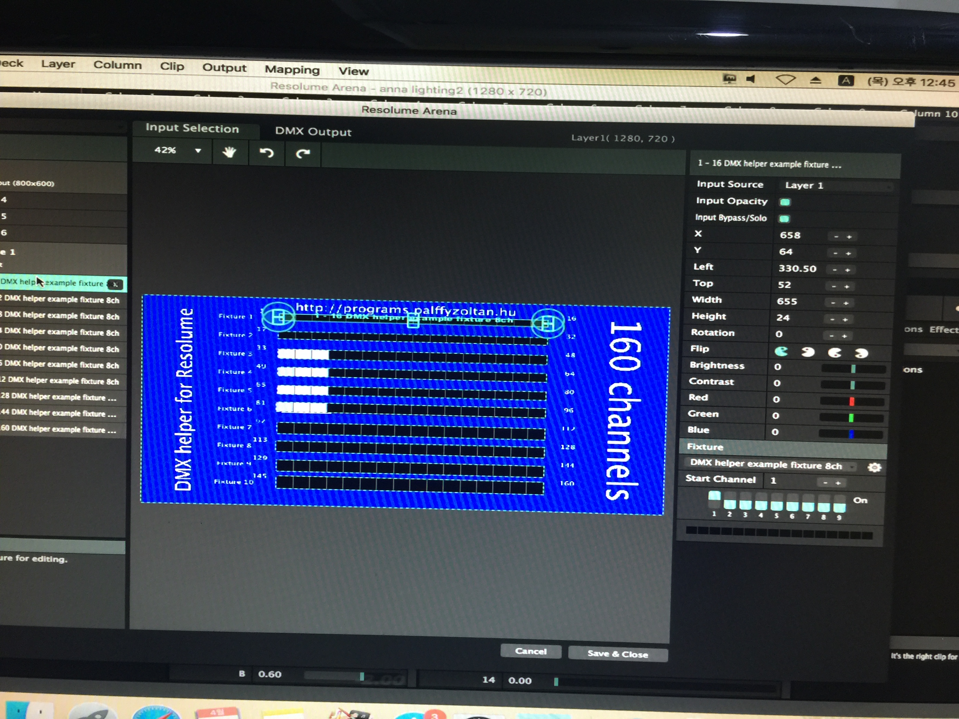

RESOLUME5 -> ENTEC DMX USB -> 512Dimmer(address1, 17) -> Led par1(address33) -> Led par2(address49) -> Led par3(address65) -> Led par4(address81) -> moving light1(address97) -> moving light2(address113) -> moving light3(address129)
I want to 3 Layers on one Lighting
so, I set the Fixture input source to layer1 and layer2
like this,

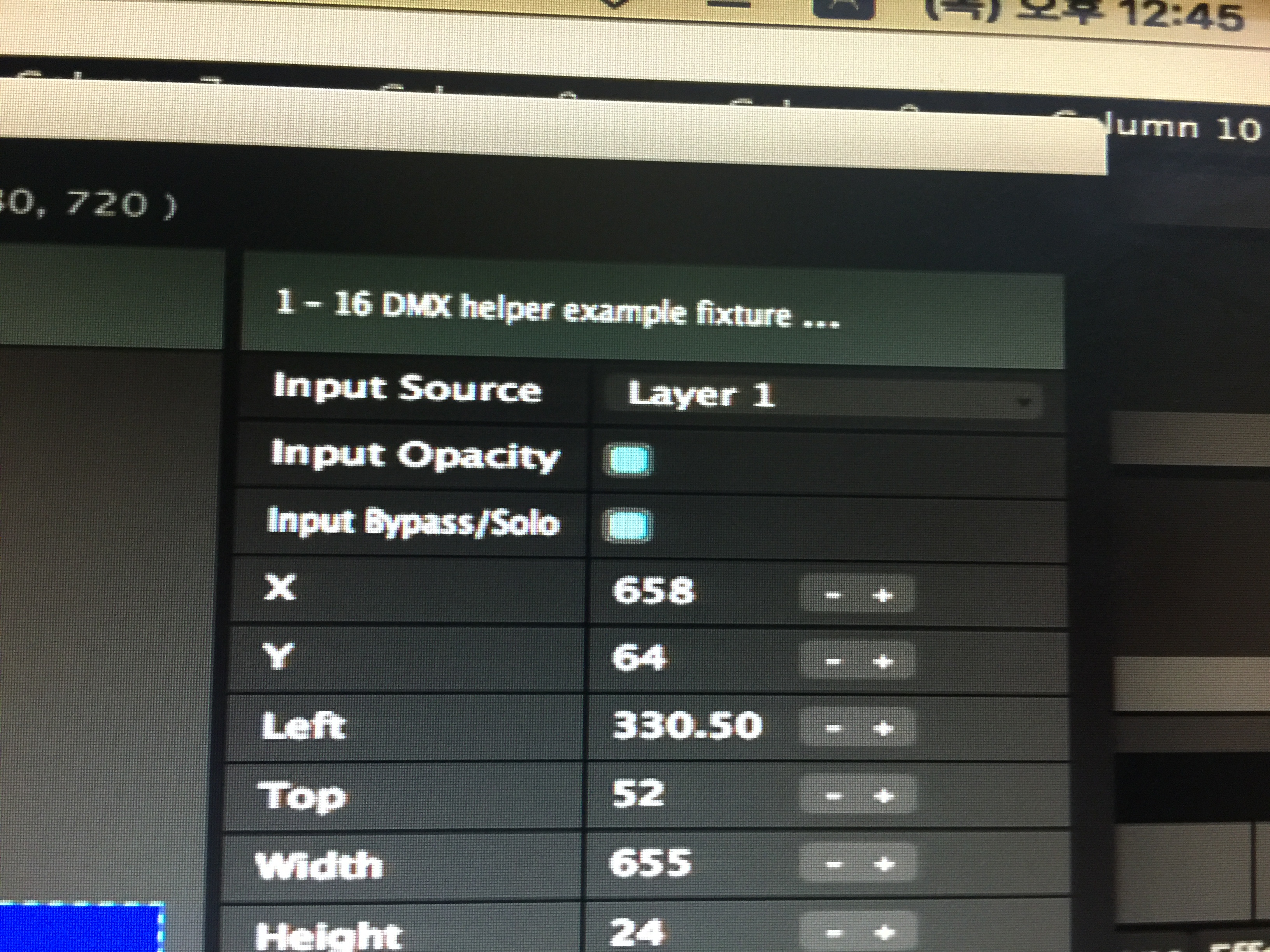

input layer1 -> 1~16ch

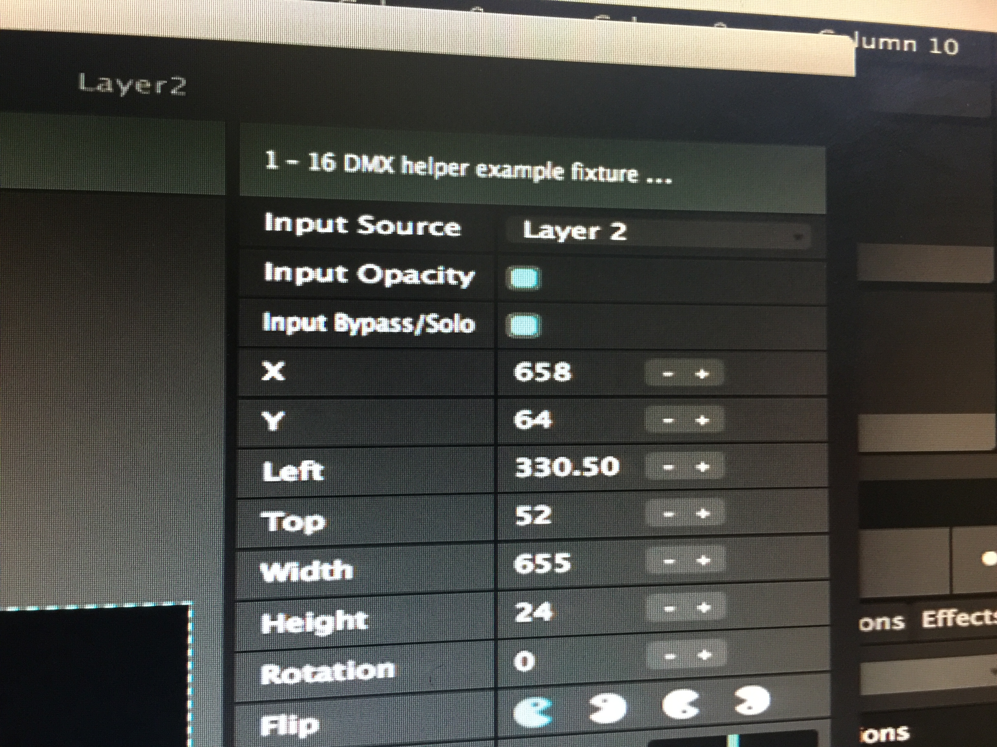

input layer2 -> 1~16ch
input layer1 -> 17~32ch
input layer2 -> 17~32ch
input layer1 -> 145~160ch
input layer2 -> 145~160ch
but, Some don't do, and some are working.
and, at advanced window
after i delect layer2, then all layer1 are working well
So, i attached some photos.
Please check the attached photos whether i set correctly or not.

you can't have two fixtures at the same channels in the same lumiverse, that won't work.
do you want to use the dmx helper to control all of the lights ?
do you need video color for the pars?

Re: control Lighting and layer
Why are you using layer to slice routing for this?
Just let your fixtures use Composition as input. Then, if you want to use layer 1, fade up layer 1, if you want to use layer 2, fade up layer 2, etc.
Keep it simple.
