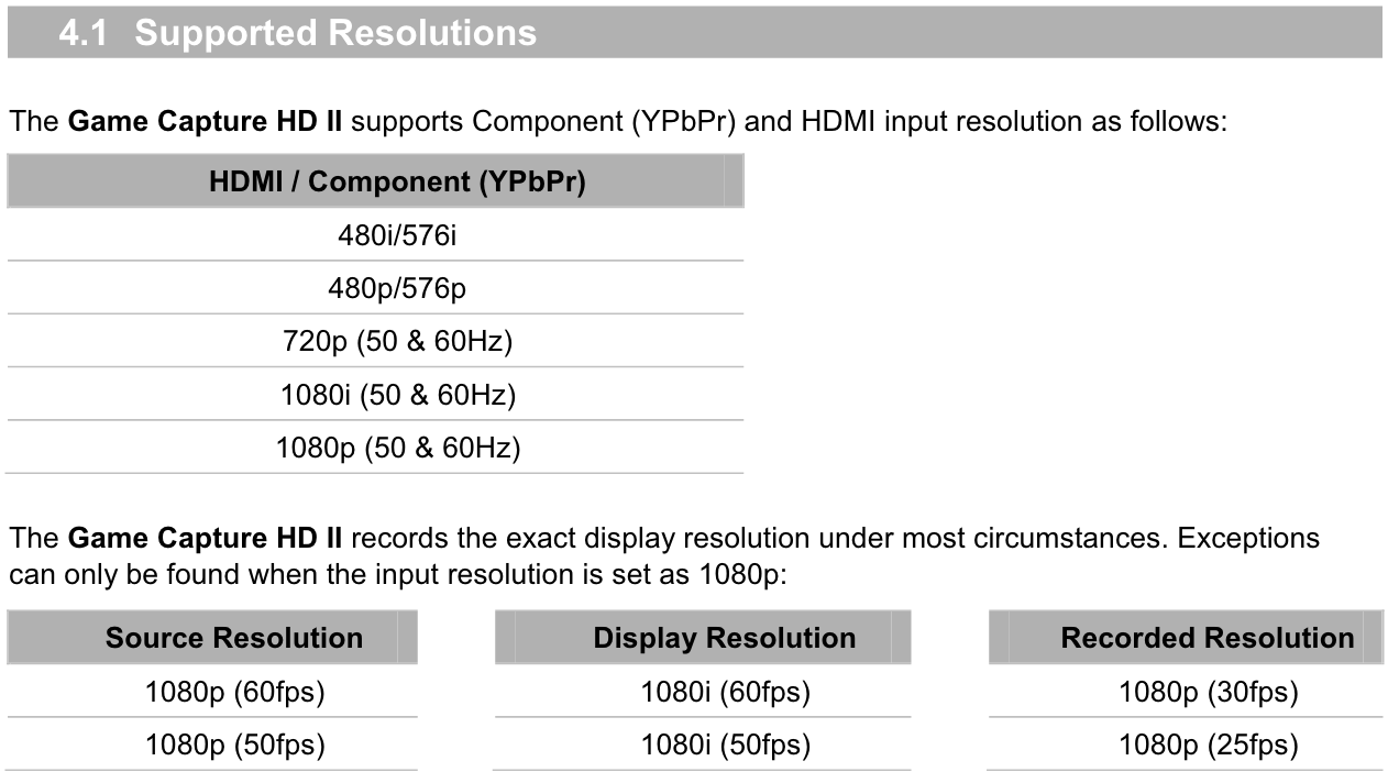

Also, here is the list of your devices' supported resolutions:
so to avoid any kind of internal conversion, I would set the resolution to 1080i50/60 assuming your drive is fast enough to record all the frames.

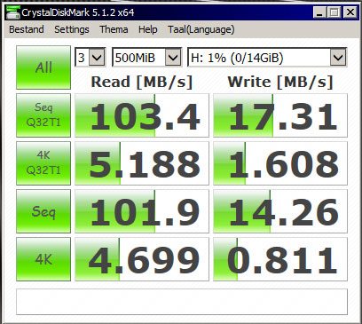

actually it's a USB stick, how does that compare in speed to SSD's or HDD's?
Re: Capturing problems: speed fluctuates
All USB sticks have different I/O speeds so it's hard to tell but they're typically pretty slow in Write mode. The only way to know what your stick can do is run it through the Blackmagic Disk Speed Test which is available on both Mac & PC.
I'm assuming you'll want 10-bit recording so so give you a sense, here are some typical data rate from this Wikipedia article on uncompressed video and I would allow for at 20% headroom to be safe :

I guess this is the problem, the usb-stick is nowhere near fast enough..I will have to try an SSD.
