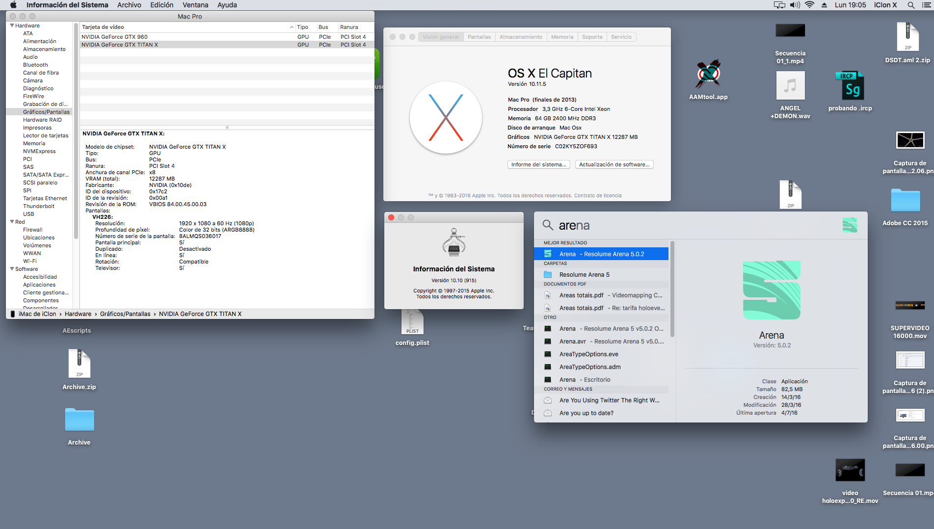

intel xeon 3,3ghz 6-core/GIGABYTE GA X 99 UD4P mother/ 64GB rAM DDR3 2400 Mhz/ dual graphics: ASUS NVIDIA TITAN X 12GB (4 monitors out) /NVIDIA GTX 960 (4 monitors out)/ harddisk1 M2 SAMSUNG 950 PRO by PCI adapter with MAC os capitan 10.11.5/ 2 harddisk2 SSD SAMSUNG with windows 10
Hello again !!

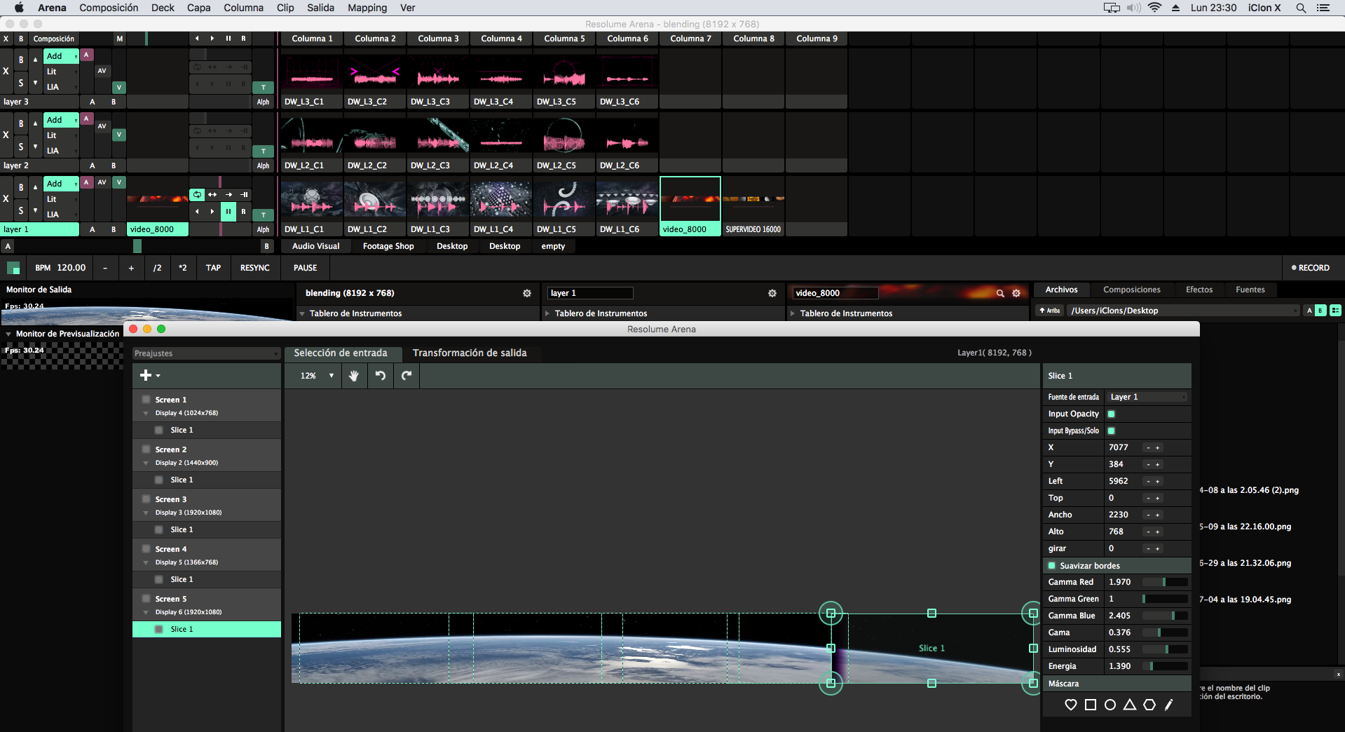

Im triying to get 7 proyectors full HD in extended mode making blending with arena without MATROX or similar external modules....no more,,,,, Im trying with the 2 actual operative system MAC and Windows....first question ...which is better system to do that ??
I prefere MAC ox, but anyway .....I create a video for 7 screens ....quicktime 13440 x 1024 DXV3 normal quality without alpha, 75% quality 24bits depthcolor,same resolution composition on arena 5.0.2 (13.440 x 1024) and TITAN X is rendering and secundary is GTX 960 and everything is ok but when I work in the avance out windows and I active the 7 outputs with diferens video areas + blending ....my frames down like 15FPS....
Is posible to do that 7 screens in full HD ?? Which is my mistake error ?? maybe need to buy another titan x o maybe more procesor Intel ??
Which codec configuration is optimus to work with this anormal bigest configuration video ??
