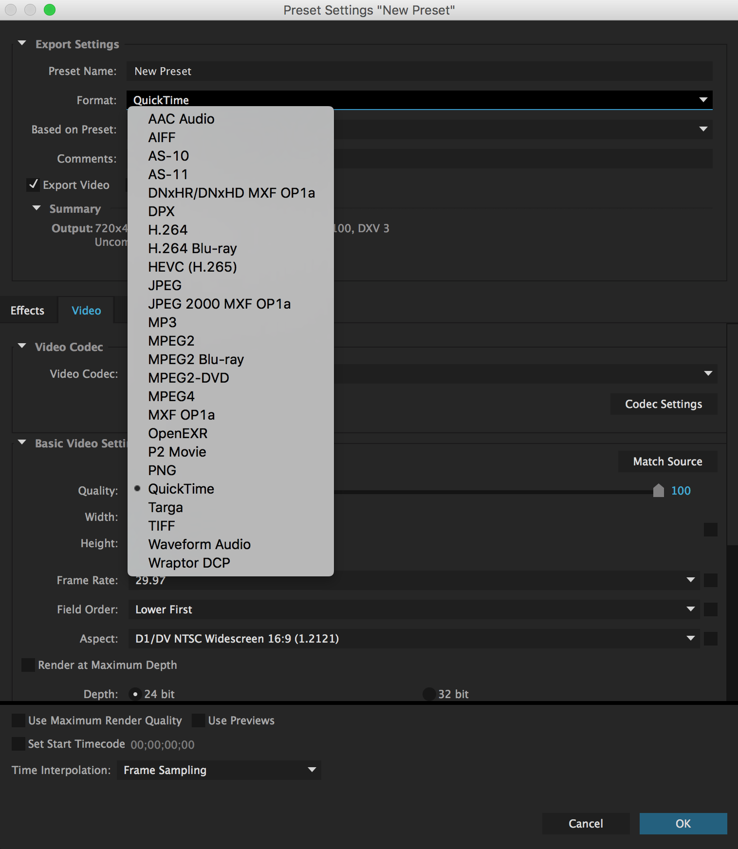

The DXV codec will be available under Video Codecs of the Quicktime format in AME. I'm attaching my presets in a zipped folder in case that can help you out.
DXV3 AME presets.zip

Thank you for the screen shot.
I do not have those codecs under Quicktime.
I am not using macOS, I am on Windows 10, x64, though the AME CC is x86.
This is what I have:

You might check your codec folder to see if they have been properly installed. Sometimes permissions won't allow the files to be copied, even when the installer says they have been.
In OSX the location is: /Library/Quicktime
For Windows I believe the location is: C:\Program Files\QuickTime\QTComponents = for 64 bit OS
Or: C:\Program Files (x86)\QuickTime\QTComponents = for 32 bit OS
*not verified, just from memory*
You should see the DXV bundles in those folders (picture attached, OSX version)
If the bundle isn't there, maybe open the DXV installer and find the bundle and do a manual copy/paste and see if that will work for you.

So those are codecs that ME can do natively without polling qt32. Try
Going to your /Library/QuickTime folder and pull out ALL of the component files. Put them on the desktop, re-launch AE and try again. You won't get some like prores but see what happens.
Start putting them back in groups and see what happens, sometimes one bad codec file will ruin the whole process. There is also a txt file you can delete to rebuild, I gotta search Google to remember what it was when I also had this a year or two ago.
