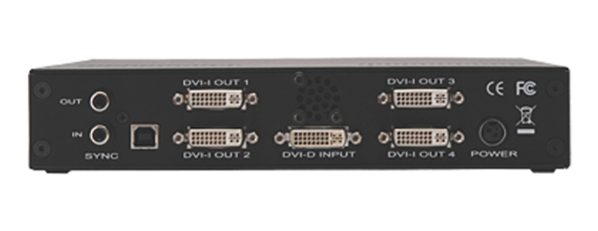

We have a workable solution using the Titan into two X4's but having some frame sync issues between the x4's (testing a blackburst external sync next)
I wonder if that worked. Can the fx4's genlock correct the unsynced GPU output?
