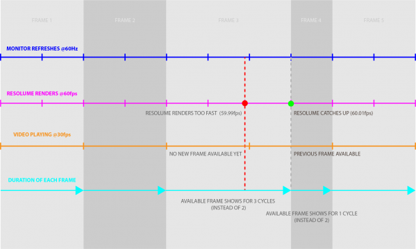

Re: So...2016 Arena 5....smooth video playback????
The problem is not your GPU settings or which build of FFMPEG is used for playback.
The problem is how to decide what frame to show.
Resolume is designed so that it doesn't matter that you play a video forwards, then backwards, skip to 2/3rds in the video with a cue point, then play it 2.33 times as fast, then set it synced to BPM, picking a new random part every beat.
To achieve this, we're constantly calculating what frame to show based on the current settings. This is a technique known as seeking. In regular timeline mode, this means that we calculate what frame will be next, based on the current frame, the current speed setting and at what fps Resolume is currently rendering.
As you can imagine, being off by just a few microseconds in this calculation can affect the displayed frame length and create what you can perceive as micro-stutters:
(This picture assumes your monitor refresh rate, Resoulme's fps and your clips fps are at exact multiples of each other. You can imagine that the difference between displayed frame lengths becomes considerably worse when rendering 23.98 fps video, while Resolume is rendering at 42 fps to a 50Hz monitor. Also, it assumes you're not using sound because then the audio buffer size and refresh rate comes into play as well).
Most video playback engines solve this problem by not seeking on every frame. Instead, they let the video 'push' a new frame when it's available. Obviously this is problematic when you cannot assume that the video plays back at its default speed.
Joris, thanks for the detailed explanation. In your diagram, what would be the reason why Resolume would render too fast which would result in having to hold a frame for an extra cycle and skip one cycle for the next one?
For a lot of the corporate, theatrical and installation work I do I use the default speed and playback smoothness is paramount for my clients so there would there be a way to offer an option to switch between seek and push modes at the clip level?
Any of one thousand different processes starting and stopping each render cycle. Remember that we're talking about the predicted time that the render cycle will complete, and which frame should be visible at that time.
That would be one obvious solution, yes.
Unfortunately this gives all sorts of unexpected behaviour, since it involves handing complete control to the playback engine, and thereby we're forced to bypass other steps in the pipeline. For instance, audio playback will use the system settings, rather than Resolume's settings. This means that by changing a clip to this playback mode, all of a sudden your audio will be routed to the system default and completely ignore the volume and master faders in Resolume.
As long as I know what to expect and it's predictable, I'd be willing to give up some control as a trade off for playback smoothness especially for corporate and installation work.
