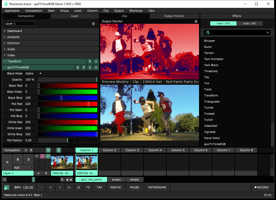

I'm glad to have been pointed to the resolume/ffgl project on GitHub by Joris, and have "ported" a plugin I made to this fork(?) of the FreeFrame SDK and can now successfully build Windows x64 DLLs. :)
Something that I have noticed, however, is that the resulting DLL is larger than expected, and building for Win32 (from more or less the same plugin code as before) is now about 20 times larger (or more) than my original project (jump from about 11kB to 263kB; the x64 DLL is 338kB).
Can anyone give me a head start on what the difference is caused by, whether some project settings need to be changed, etc?
-subpixel.

Gnarly... When you use the custom types for parameters you get a multi mode colour picker.
Code: Select all
// Added by Resolume for HSB colors
#define FF_TYPE_HUE					200
#define FF_TYPE_SATURATION			201
#define FF_TYPE_BRIGHTNESS			202
I haven't tried to get the alpha value out yet. What type/number should it be?
