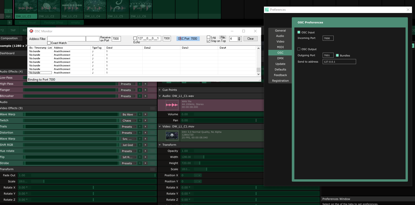

Hi everybody, I'm having trouble getting Arena 5 to react to OSC commands sent from a connected arduino. I want to have commands that can trigger each column, and according to the OSC map this is: /track1/connect (Int 0 or 1), track2, track3, so on. I know my commands are reaching the server computer, but Resolume is not responding. Here's a screenshot of OSC Monitor. Any insights as to what I am doing wrong?

Check your firewall settings.

You also have to exit OSC mapping to have Resolume react.
Masks sure only one application listens on the specified input port, Resume tries to bind to the port on app launch, so a program restart may be needed.
