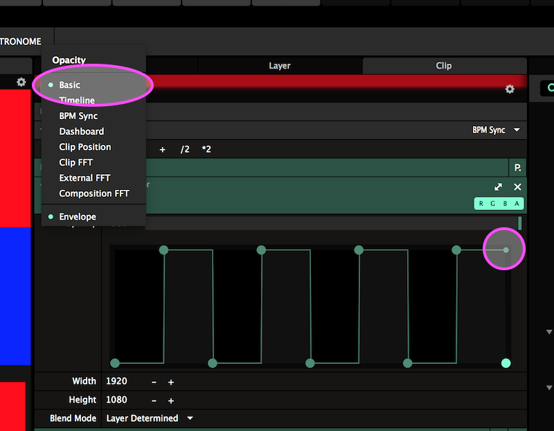

Thanks for the additional notes! I got it figured out now and realise I misunderstood the application of 'Hold', as Zoltán pointed out and was also distracted by a very minor visual difference, highlighted in the attached 2 screenshots. With some of the 'origins' for a value there's a distinct smaller dot, which is not present when you pick 'Clip Position' as the 'origin'.Oaktown wrote:In your example, since the third keyframe is at 100% you can’t see the line but if you move it down, you will see the line if you set the fourth (and final) keyframe to ‘Hold’ the value from the third keyframe until you reach the fourth (and final) keyframe.
Re: [Envelope] Cannot apply Hold to last Envelope anchor
The small dot is the actual value position based on the parameter timeline/slider.
It's there in your second screenshot too, about in the middle of the envelope.
